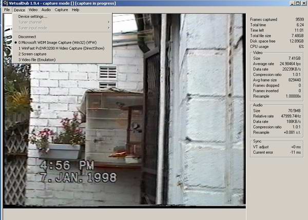

    I've had another go at VirtualDub and finally got it running. The breakthrough was when I noticed "Capture.avi" low down under the "File" menu. That in turn opened up the 4 capture options under the "Device" tab and away I went. It was immediately obvious that the video was much better than that in the Leadtek Tuner window. It didn't make much difference to the bad frames though, but I now have a fine piece of software to use when I get that problem solved. Trying to upload 2 images using the "browse" window below, which saves me going via ImageShack, but I'm having about as much luck as I did with that "mpg" upload !

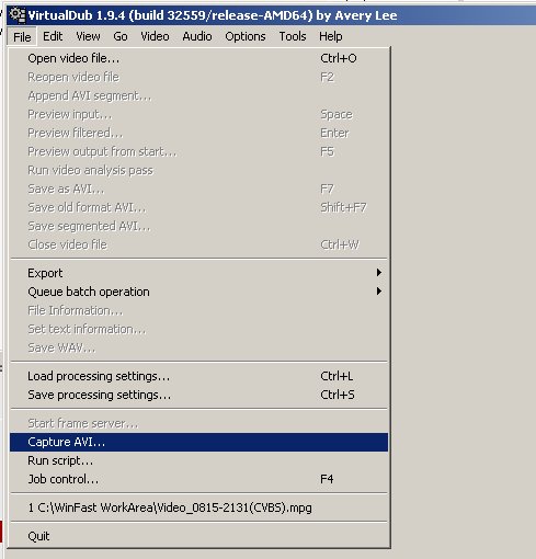

    Here's the page and tab that got me started
