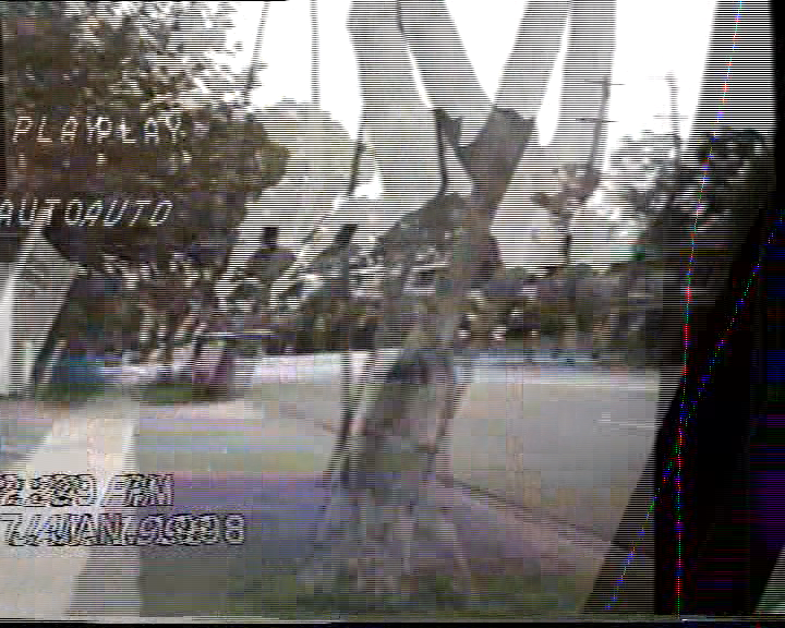

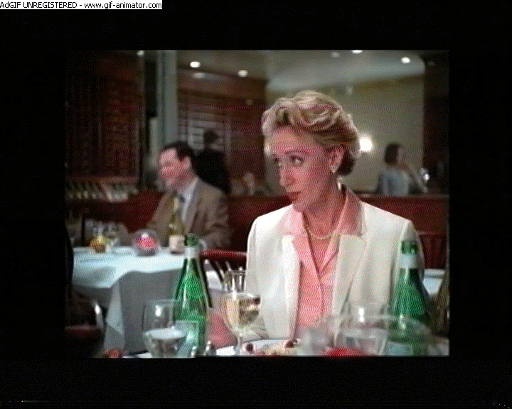

I'm trying to copy VHS tapes to my PC via a Leadtek 3200H Tuner card. All of my tapes play back perfectly via my main 40" samsung HDTV. When I play them back using the same VCR into my PC via the 3200H, the picture is "shearing" in places and almost unwatchable, but here's the very strange part. The picture is stable if the original use of the camera that recorded the video wasn't panning too much. If the original scenes were shot from a tripod or the camera was fairly static, there is no problem with the playback on the PC, but a scene taken for instance, where I was walking down the road, is almost impossible viewing. It can't be the tape or the original recording because all of the tapes still play back perfectly on my normal TV ! I don't intend to burn to DVD as I want to copy about 40 four hour tapes to a 1TB HDD. All of these tapes are home videos and most of them were analogue. I have copied later digital vide camera tapes to this same PC via USB without a problem.
My system is Vista 64- E8500 processor-Asus Rampage Formula-8800GTS graphics-4GB ram. The VCR is a Sanyo VK910A and I have two of them. Both have the same problem connected to the PC and both play all tapes perfectly to the TV.The 3200H Tuner card records HDTV flawlessly to this same PC.

I forgot to mention that my monitor is a 24"Dell 1920 x 1200. I have changed various resolutions and changed the hertz to all available options. I have just connected the yellow video cable direct to the monitor and the same tape plays back perfectly on the monitor. I have also just removed the sound card that came with the Asus M/B as I've read here that that might affect things but it has made no difference.

By shearing do you mean it looks like part of the picture has shifted to one side? Like in the AVI sample here:
https://forum.videohelp.com/topic362002.html#1924269 -
I tried to take a screenshot and either got a blue screen or a jpg that itself was shimmering, but when I tried to upload that I again got a blue screen image. Here is a shot taken with a digital camerawhich gives you some idea of the problem. This shearing/flickering takes place many times a second. However, if I had been standing still when the video was taken, the problem would not be there. Second shot from same tape. any part of tape where camera was fairly steady is like the second jpg and the whole tape is fine when viewed on a TV. Thanks for your quick response. I hadn't realised that I could post a screenshot here.
Fred

I'm not sure I can really tell what's going on from your snapshots. I suspect you just have a playback issue with interlaced video. Can you post a second or two of the captured video? Or open one of your caps with VirtualDubMod. What do you see there? You can select Video -> Snapshot Source Frame and save as a PNG file.

Looks like some sort of blen de-interlacing, maybe the vertical resolution is set to 240 rather that 480. What that basically means is that the card is taking two images which should take up the full screen, seperated by a fraction of a second, and merging them. A stationary shot masks this effect.
The "smeared" clip you posted is a pretty extreme example. Are most of them more like a sort of ghost or double image? Was camera movement severe for the first pic, if you look at the angles of the trees, did the camera swing that much in roughly 1/30 of a second?

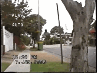

Your recording device is losing sync. This has nothing to do with what settings you use in the capture software. The tape may have a weak sync level or it may be stretched. You might be able to clean it up with a video stabilizer or time base corrector.
VirtualDub and VirtualDubMod had no problem opening the files you posted. A sample "bad" frame:
Animated sequence of one field only, reduced to 320x240, 2 fps:
