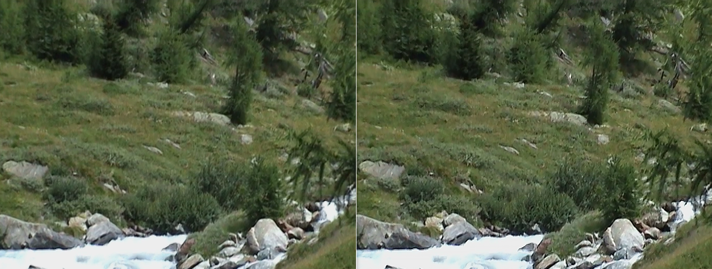

    I'm trying to sharpen the video with aSharp. But then, I see some kind of horizontal edges appearing. You can see it especially near the edges of the water and on the rock in the lower right corner. See picture:
    You can see, if looking carefully, the horizontal lines also appear in the before picture. So, is this coming from the TGMC filter?
    This is the code I used:
    SetMTMode(2,0)
    LoadPlugin("C:\Program Files\AviSynth 2.5\plugins\Convolution3d.dll")
    AviSource("C:\Users\L.J.P. Verhees\Desktop\losse stukjes\Interlaced_Deshaked.avi")
    SeparateFields()
    odd=SelectOdd.Convolution3D (0, 6, 10, 6, 8, 2.8, 0)
    evn=SelectEven.Convolution3D (0, 6, 10, 6, 8, 2.8, 0)
    Interleave(evn,odd)
    Weave()
    DoubleWeave.SelectOdd()
    Tweak(sat=1.1,cont=0.94)
    ConvertToYV12(interlaced=true)
    AssumeBFF()
    TempGaussMC_beta1()
    SelectEven()
    aSharp()
  4. Yes, those horizontal lines are imperfections in the deinterlacing. And you are way over sharpening.

    Is there a way to remove these horizontal lines (e.g. by changing settings in TGMC or changing something else?), or must I live with them (and turn the sharpening a bit down)?
  6. TempGauss is currently the best deinterlacer. One thing you can do after TempGauss is
    Blur(0, 1.0)
    Sharpen(0, 0.7)
    The Blur() will blur away the comb artifacts and the Sharpen() will restore most of the crispness to other horizontal edges (without restoring the comb artifacts). You can sharpen more but you'll get start getting halos. If you're going to use ASharpen() afterwards you might get away with less sharpening.
    There is one way to make sure no interlaced artifacts get like that get through, but you'll lose half the vertical detail and end up with jagged, buzzing, near horizontal edges. Just use:
    SeparateFields()
    SelectEven() #or odd
    WhateverResize() # to desired size
    Jun 2005
    The Netherlands

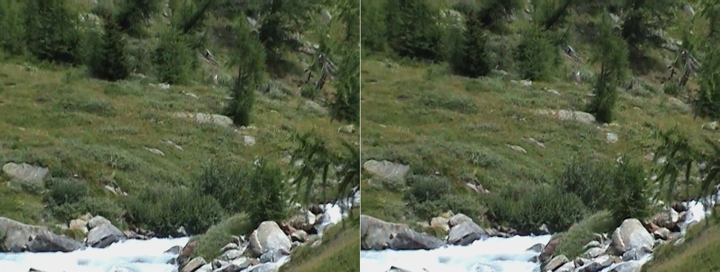

    Thanks. I used
    Blur(0,1.0)
    Sharpen(0,1.0)
    Works beautifully! See below:

  11. Member Alex_ander's Avatar
    Oct 2006
    Russian Federation
    Those artifacts (repeating horizontal edges) look typical of processing separated fields with a spacial filter and probably appear at 'Convolution' step (you can check this by disabling the rest of the script). Since filtering changes spacial position of horizontal edges, they may look almost as bad as in case of resizing separate fields. The reason is that processing inside a field can only move object edges vertically by 2-pixel step (within that field) and they can't get to the adjacent field. So after combining fields back the empty spaces appear between objects and their horizontal edges. You could use that filter on progressive instead, e.g. just after TempGaussMC.
    Jun 2005

    @ Alex_ander (and others of course): I tried to remove the convolution step, so I only had the TGMC. But also then the horizontal lines appeared. So the lines come definitely from the deinterlaceing process. The best way to remove these lines, as far as I can judge, is to use the Blur(0, 1.0) and Sharpen(0, 0.8 ) filters after TGMC. This really does an outstanding job of removing the horizontal lines.
