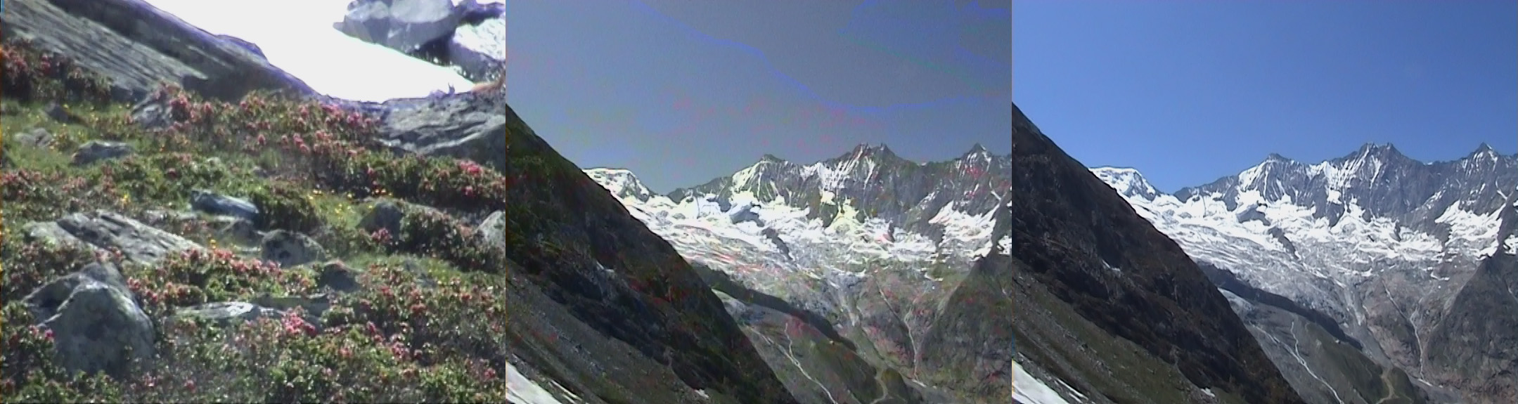

Also, I get some weird effects with TGMC (both the normal and the modded version). In the file attached, three successive frames can be seen. The second frame has the weird effect. Is there a way to avoid this?

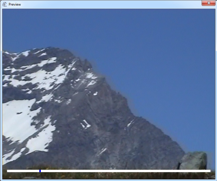

I also discovered some strange halo's, see picture (along the right side of themountain and the rock in the lower right corner):
Here is the script I used:
Code:LoadPlugin("C:\Program Files\AviSynth 2.5\plugins\Convolution3d.dll") AviSource("C:\Users\L.J.P. Verhees\Desktop\losse stukjes\Interlaced.avi") SeparateFields() odd=SelectOdd.Convolution3D (0, 6, 10, 6, 8, 2.8, 0) evn=SelectEven.Convolution3D (0, 6, 10, 6, 8, 2.8, 0) Interleave(evn,odd) Weave() DoubleWeave.SelectOdd() Tweak(sat=1.1,cont=0.94) ConvertToYV12() AssumeBFF() TempGaussMC_beta1() SelectEven()
