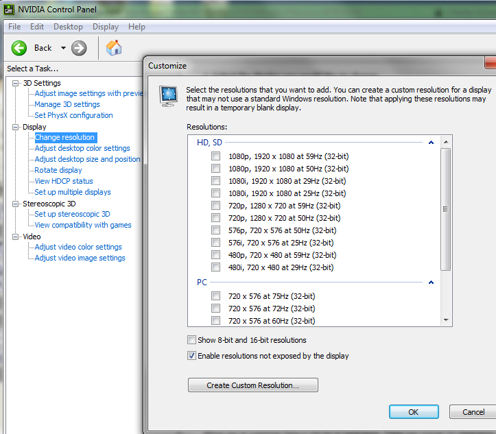

  16. Playing the captured file from the PC/notebook (via HDMI OUT) and viewing it in a 1080p full HD TV will have the same display quality as playing the video directly from the tape (camcorder connected to TV via HDMI)?
  17. Member edDV's Avatar
    Mar 2004
    Northern California, USA
    Similar but not the same. Different hardware is being used.
    HDV format on tape is 4:2:0 sampled, 1440x1080 60i.
    When played out the HDMI port, the camcorder hardware resamples chroma and rescales luma to 4:2:2 1920x1080 60i. The HDTV will then deinterlace to 1920x1080 60p or frame repeat to 120p.
    The HDV mts file captured to PC disk is identical to the data on tape, that is 4:2:0 sampled, 1440x1080 60i. Playback to the PC HDMI port varies by the software player used, player settings and the display card settings. Let's assume VLC as player and a typical NVIDIA display card.
    The NVIDIA control panel allows setting the HDMI port to 1920x1080 60i (aka 29.97 fps) or 1920x1080 60p (aka 59.94 fps).

    If you set output to 60i and run VLC in deinterlace off mode, then the VLC player (or NVIDIA hardware in DXVA mode) will rescale 1440x1080 60i to 1920x1080 60i and resample chroma from 4:2:0 to 4:2:2. If set up properly, the HDTV will then deinterlace to 1920x1080 60p or frame repeat to 120p.
    With the more common 60p HDMI output setting, The software player or display card hardware will perform the deinterlace, chroma resample and luma resize depending on player settings. Then the HDTV simply displays 60p or frame repeats to 120p.

  18. Originally Posted by edDV View Post
    Is that the "1080p, 1920x1080 at 59Hz" option that shows in the Control Panel?
    I've read that Adobe software is optimized for Nvidia cards. Would you recommend Nvidia over ATI?
    "59Hz" yes (actual is 59.94 Hz)
