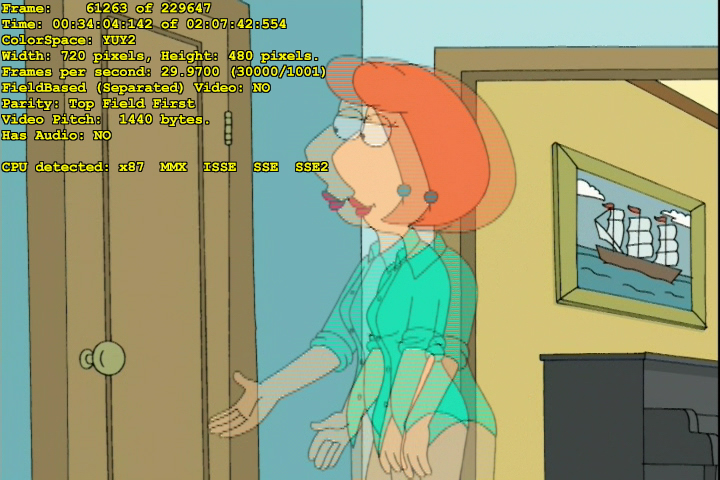

I am seriously impressed with TempGauss, I just don't know if my portable DVD player will play 60 fps DivX files. how much larger are they on average than their 30fps counterparts?
Also, jagabo, I used the area based filter from the link you provided in AviSynth, and it's giving me that same chroma interlacing problem in the blend we were talking about before (the reason I switched to VirtualDubMod). What's up with that? -

Added ConverttoYUY2 and it didn't change anything, here's a pic.
[/img]

What is your script for handling the MPEG source? It shouldn't be doing that. It should look something like:
Code:Load_Stdcall_plugin("C:\Program Files\AviSynth 2.5\plugins\yadif.dll") MPEG2Source("VTS_01_6.d2v") Yadif(mode=1, order=1) # mode=0 gives 30 fps, 1 give 60 fps, order=0 for BFF, 1 for TFF # at this point you will have progressive YV12 which isn't a problem for # VirtualDub or Mod so there's no need to convert to YUY2Did you set DgIndex to honor pulldown flags?Code:import("C:\Program Files\AviSynth 2.5\plugins\TempGaussMC_beta1.avs") MPEG2Source("VTS_01_6.d2v") AssumeTFF() #or AssumeBFF() TempGaussMC_beta1() TDecimate(mode=7, rate=23.976) # or 29.97, if necessary # at this point you will have progressive YV12 which isn't a problem for # VirtualDub or Mod so there's no need to convert to YUY2 -

I don’t think the fact that it is a hybrid is an issue for the deinterlacing, because I’ve been able to get good results using the same area filter in VirtualDubMod. I only get the weird chroma issues when using the area filter in AviSynth. Here’s the code:
loadplugin("C:/Program Files/DGMPGDec 1.5.5/DGDecode.dll")
loadplugin("C:/Program Files/AviSynth 2.5/plugins/area.dll")
MPEG2Source("I:/FamilyGuyStream/FamilyGuyDisc.d2v")
ConvertToRGB32()
Area(deint=10,edge=20,blend=true,show=false)
ConverttoYUY2(interlaced=false)
I put false because it should be progressive at this point, but either way I get the same result. -
Ah, your problem is the ConvertToRGB32(). It should include interlaced=true, otherwise it will make the same mistake as VirtualDub. No need for the ConvertToYUY2 at the end.Originally Posted by jieve

Exactly, I noticed just before I got your post that everything had blue and red lines in it, so it had to be the conversion. Works great now. I tried both scripts, they look very similar, except I think the area based keeps the entire picture a little bit sharper in general. I want to try that TempGaussBeta, any idea what the error message meant that I got?
