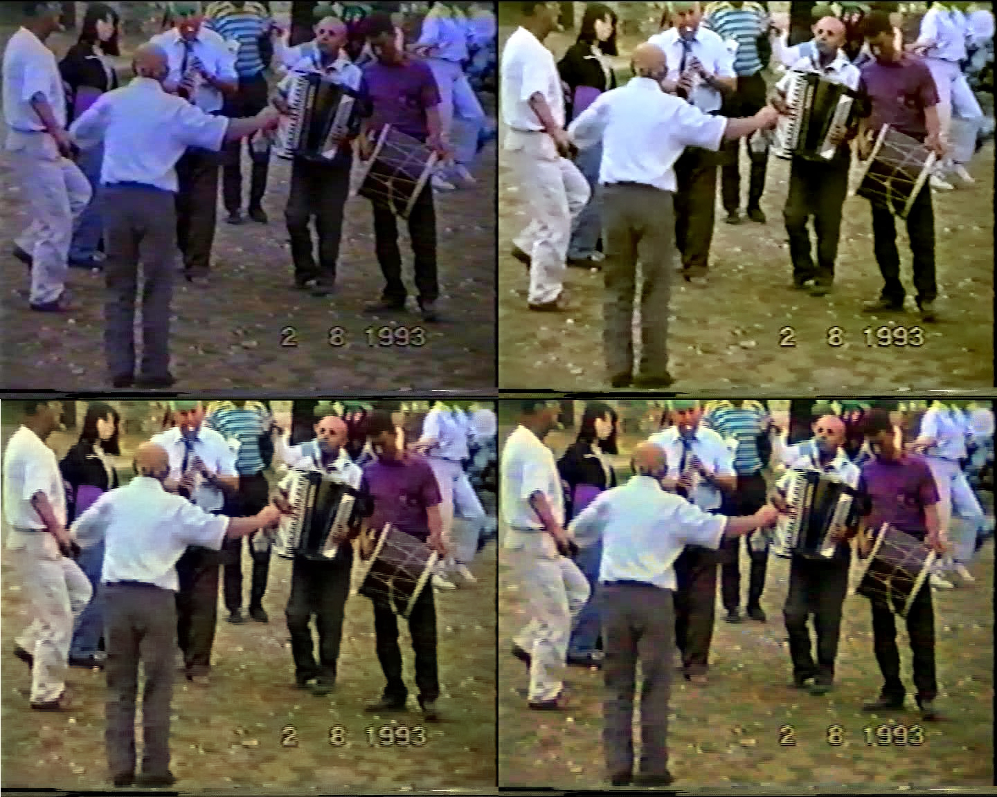

    p.s. i did some color sorections experiments vith another video from 1993, but i cant find a avisynth replacement for camcorder color denoise, and here is an example of before and afther.
    The up/left is the original, right/up i virtualdub+tmpenq, and below is first and second try with magix video edit(it supports virtualdub filters, but not the camcorder color denoise )

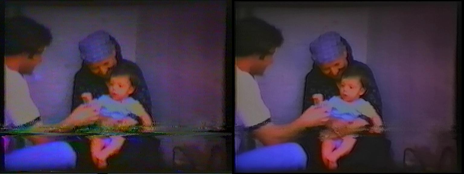

    Hi again, yesterday i tried avs script for "restoring old 8mm films" made by videoFred,
    and i'd like to share the result with you.
    This script is not intended for vhs, but.. obviously it works nice if you tweak
    the settings according to you're video source.
    BIG thanks to videoFred and all the others who participated in the making of the script

    Jagabo, im not sure if i am alowed to link to another forum.. so just search on google for "The power of Avisynth: restoring old 8mm films" .
    I have tried Neat Video, its a powerful denoiser, but if you look closer on my screenshot.. you can see that this script kind of "fixed" the tbc error's, and that's probably the most important reason for this improvement, not the denoising part.
    Im not very good at avisynth scripting, but i'll try to findout what part of the script is doing that fixing.

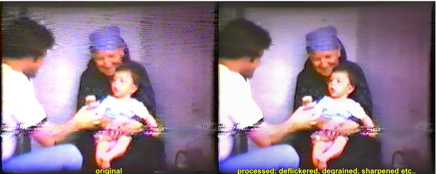

    I didn't give up
    After ~2 years i think i'm close to the result i want, using ONLY avisynth
    I used poisondeathray's script as a good start, and then i added it as a source to some script from Didée that he vrote somewhere on Doom9, i dont know what the script was for originally, but it shore does its magic in my case.
    Not that there is anything that I DID, i just used other's people ideas.
    Thank you.
    p.s. i didn't edit the color's e.t.c., that is yet to come, i was aiming to fixing the tracking "thing".
    p.p.s. the whole script run's at 0.4 fps when encoding to mjepg with virtualdub

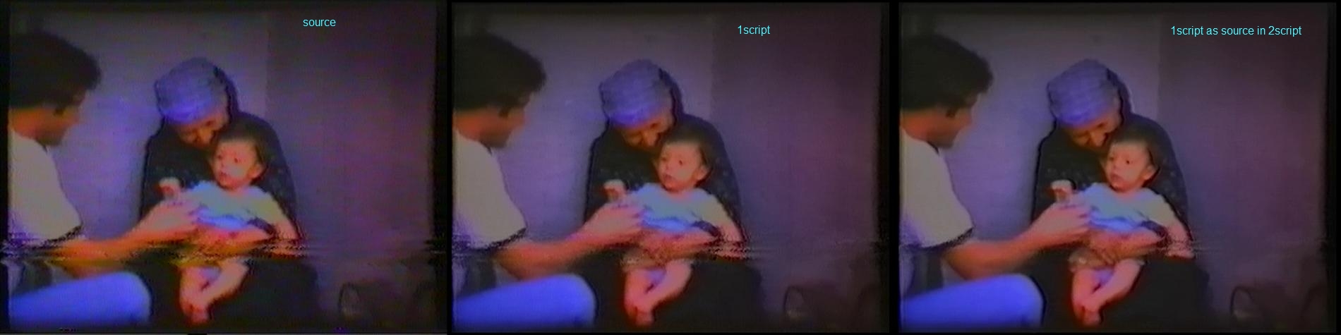

    Thank's poisondeathray, this are the scripts, but i didnt tweak anything, so there might be a room for improvement.
    source script
    second script
    edit: this is screenshot of the 2 steps, source=>poisondeathray's script=>Didée's script
