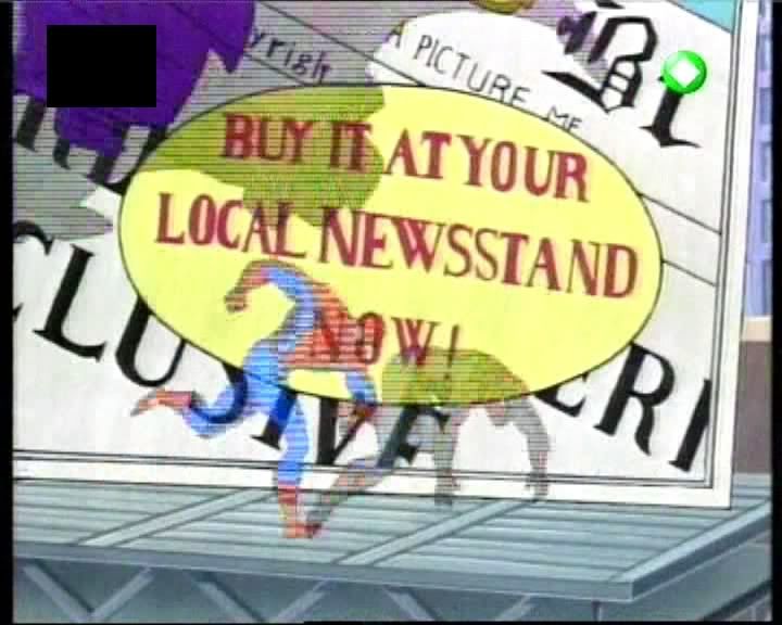

    This is a captured frame after i made it as dvd file with ConvertX toDVD (i use cartoon because is more sensitive in interlaced).
  12. To deinterlace for Xvid encoding I would try Donald Graft's Smart Deinterlace filter in Edge Directed Interpolate mode. That's about the best deinterlacer in VirtualDub. For really good deinterlacing you would want to use AviSynth's TempGaussMC_beta1(). It's really slow though.
    There's one other possibility since you're in a PAL area. The video may simply have a phase shift. If so, you can easily go back to progressive frames. Open one of your videos in VirtualDub. Apply the Bob Doubler filter. Use Bob mode and the appropriate field order. If you find that every pair of fields are nearly identical you can restore the progressive frames with AviSynth's TDeint(). This would give the best results.

    That may not mean anything. MediaInfo is simply reporting the flags in the header -- the header may be wrong. How do the frames look after capture? I guess they look ok since you're not complaining about them!

  16. Originally Posted by Docoptik
    Yep no interlaced at all. I used Virtualdub to see frame by frame. No problemo.
    You may be missing half the picture though.
    There's another issue you should be aware of: VirtualDub does not handle interlaced YV12 sources correctly. The striping in the sample you posted looks like this error to me. You can get around this problem by using VirtualDubMod or using AviSynth to open the file and converting to YUY2 (ConvertToYUY2(interlaced=true)) before VirtualDub.
