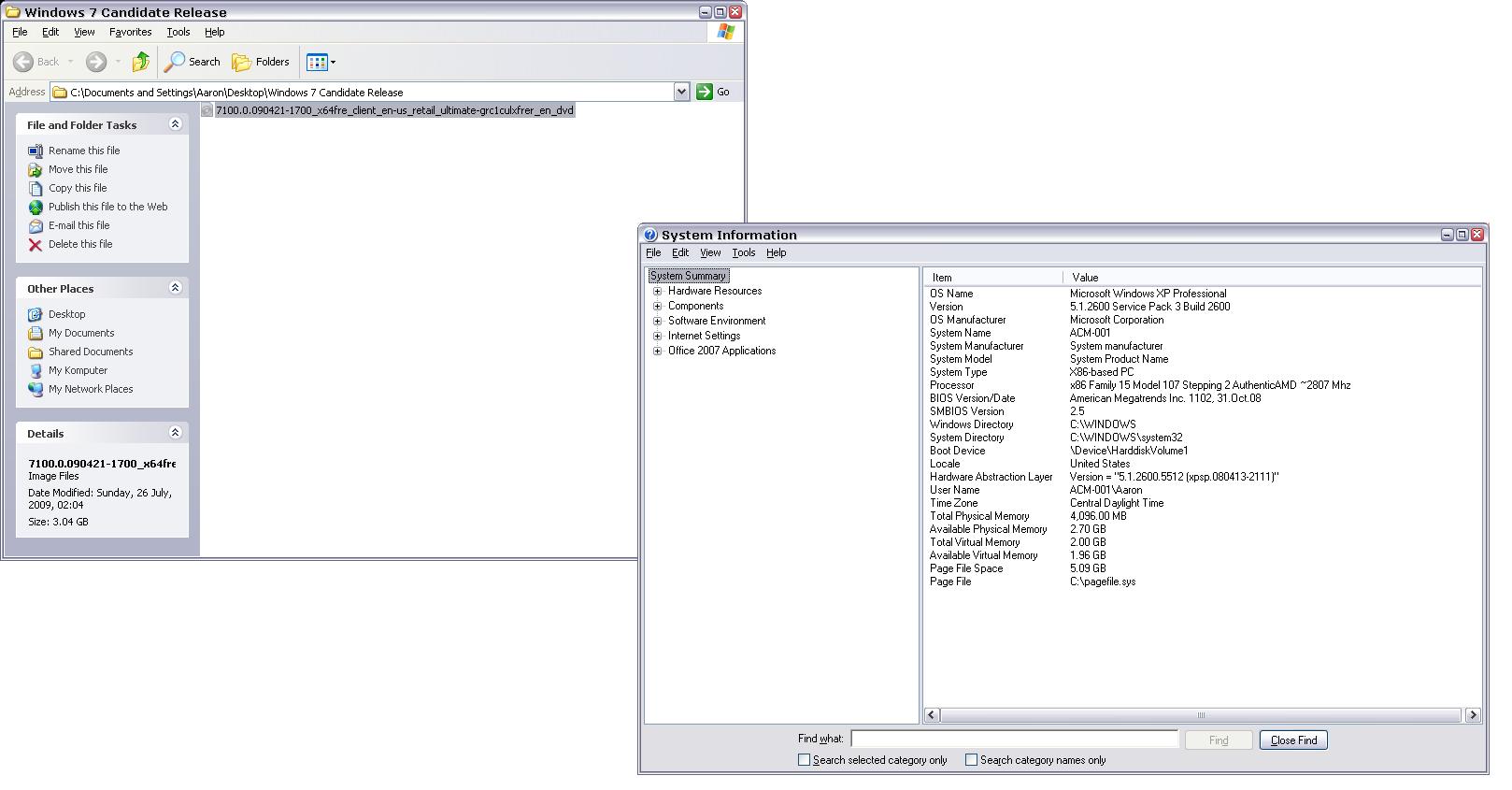

OK, so I downloaded the Win7 Release Candidate from Microsoft, no big deal. Now, I have made several coasters out of my DVD+Rs, I can't get the ISO image to boot. I have used Nero (Express Essentials) and ImgBurn (v2.5.0.0), neither yields a bootable DVD disc. IDK what I am doing wrong? The Nero version I have does not include an option to make a "bootable" disc. This is driving me nuts. I have the partition all ready to go and can't get anything loaded into it.![]()

US, the Release Candidate. It's the file MS had me DL. It's 3.04GB, took me all day to DL. IDK what I did wrong. do I have to save it as an ISO image? I think it should already be in that format, right?

The Win7 RC image is not a bootable image. it is an upgrade from existing installation... so it doesn't boot.
Run it from your installed Windows

I am trying to install it as a dual-boot OS, so I can keep WinXPpro and switch between them. This is my first time attempting a dual-boot setup, which is why it's driving me nuts that my discs won't just boot. I am very appreciative of everyone for his/her help.

I already have WinXP installed. Do I have to do the backup, wipe and clean install of XP... I've read a few things that say that. They might just be assuming you are doing two fresh installs?

OK, fellas, this is good news! I am currently IN Windows 7RC! This thing just fires right up... I can't believe how easy it is.
I had to unplug the IDE DVD-ROM drive in order for the BIOS in my mobo to allow the SATA drive to run first. I tried to use the IDE drive for the boot and it just wouldn't. I don't get that at all...
