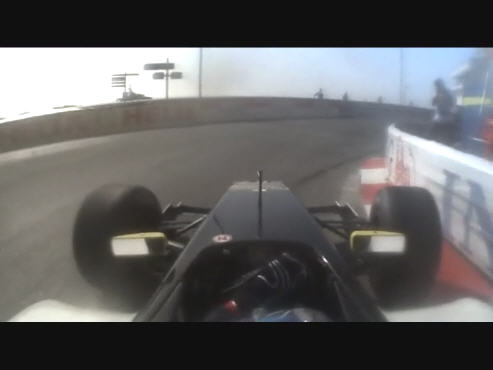

    What's the best way to remove the black frame from around Windows Media Audio/Video footage?

    See image for black areas I want to remove.

    From your picture it looks like you are displaying wide angle movie as a letterbox on 4:3 screen.
    If you just remove black lines video will become distorted. For full and correct display on 4:3 screen, you will have to crop sides also. You can use AVIDemux (free) or get something like TMPGEnc Xpress (not free).
    I am sure there will be others with software suggestions.
    Other way is to encode as Pan and Scan, that way black lines will not be there on 4:3 screen, but picture will be narrower also.

    Also, good players will add black bars to footage that does not have any to preserve the correct aspect ratio.
    Cropping also means you will have to re-encode the entire video. Virtualdub is another option. Video->Filters. Add a null transform filter, then crop
