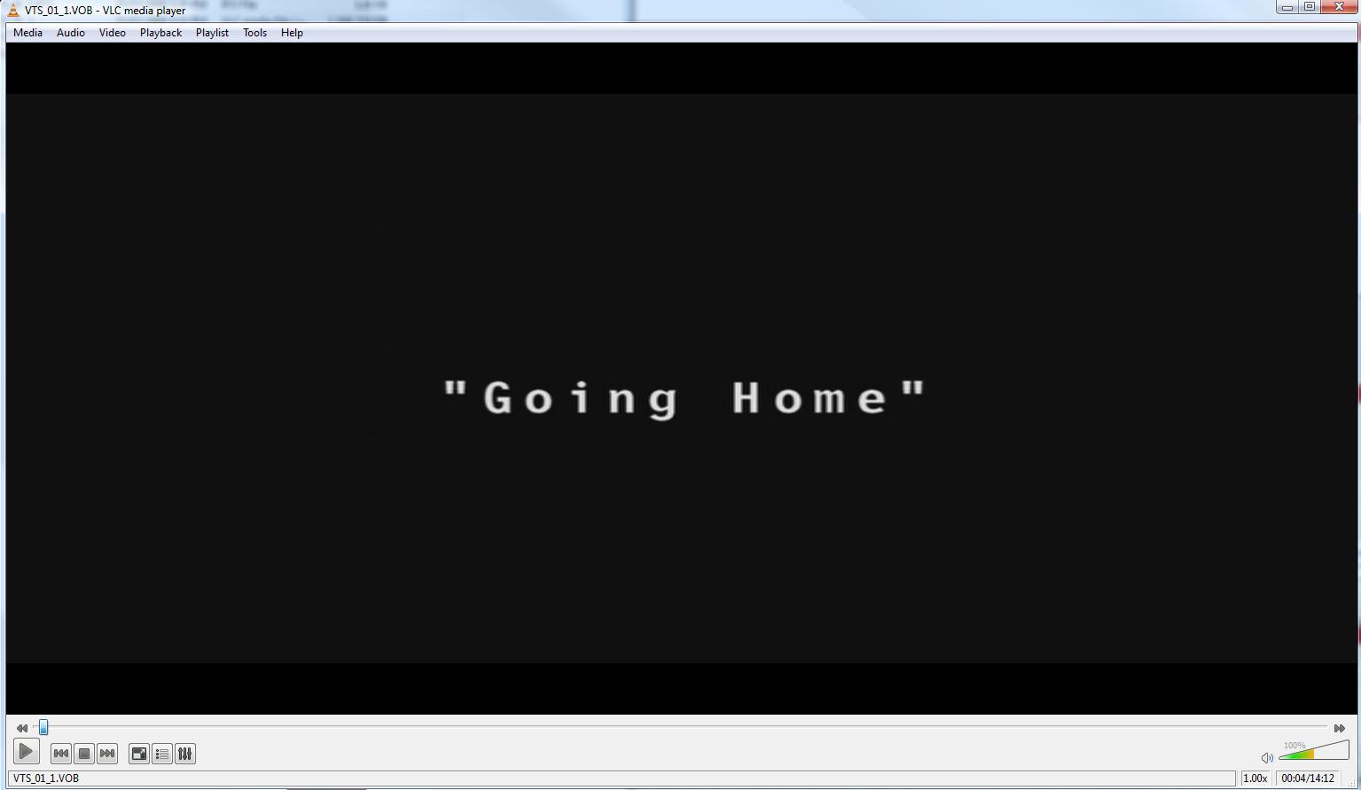

    When I play the movie from the dvd itself this is what it looks like (file is attached).
    However once it is encoded the file plays in 4:3 in wmp, mpc. vlc.
    I use dvd decrypter to rip to the hard drive.
    Also something else I have noticed is that the first second or two of the dvd play in 4:3 but the rest plays in 16:9 could this have something to do with it?
