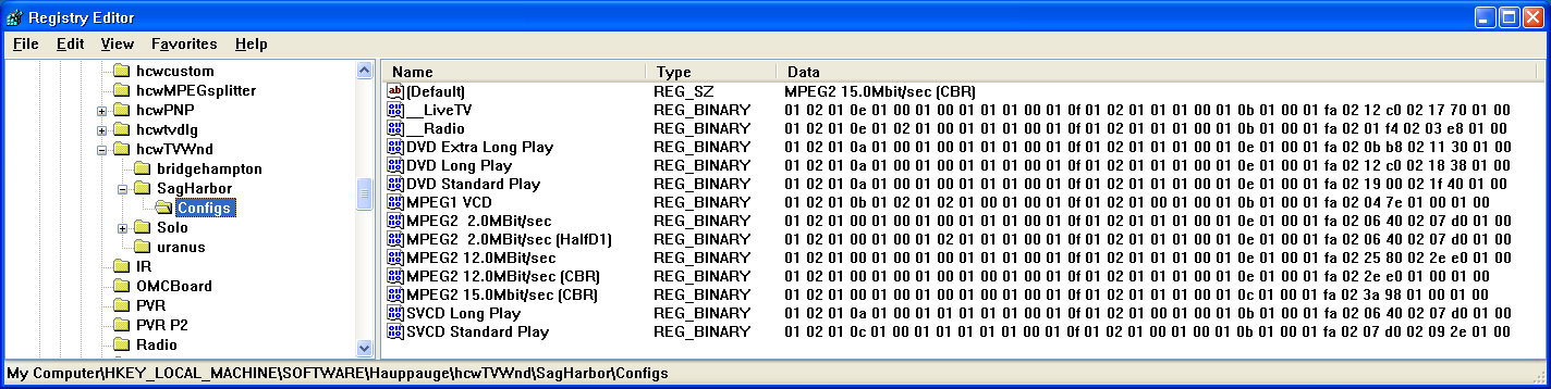

    You'll need to install WinTV 2000 if you want to capture analog cable or VHS at higher bitrates. WinTV6 only has one preset, DVD 2408kbps. To capture digital channels then you'll need to use WinTV6. I tried WinTV7 which captures digital to TS instead of PS but the OTA digital tuner doesn't pull in near as many channels with WinTV7 that WinTV6 does.
  7. You might be able to fiddle with the registry to add new templates. Here are the registry entries for the PVR-250 and WinTV2000:

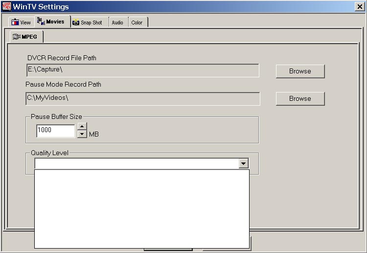

    Okay, I was able to take out the 1800 card, ran Hauppauge's program to clear all the software & drivers, then reinstalled my 250 card and it was working just fine with WinTV2000, showing the 12MBps setting that I've always used I was using that this week until I had enough time to try to 1800 card again.
    Today, I ran the Hauppauge software to clear all of their software and drivers, took out the 250 card and reinstalled the 1800. Installation went fine but when I open up WinTV6, once again the 12MBps setting is missing. I don't understand why this newer card won't let me use the higher quality setting my old card used. The Hauppauge website shows that 12MBps setting on the WinTV6 page and apparently this 1800 card is capable of capturing at that setting. I just can't set it for that.
    Does anybody know what I'm doing wrong or how I could fix this? In the meantime, I'm uninstalling the 1800 and reinstalling the 250 again.

    The WinTV software is the problem and the hcwclear program since it does not get rid of everything. I used the hcwclear and then installed the drivers for 4.8a, WinTV2000, WinTV6 4.8a, the radio and signal monitor. When I opened up the TV to check the MPEG settings, a channel was already playing and under MPEG settings, nothing was there (before at least I had one setting). All of my channels that I had set before were still there. As long as the hcwclear will not completely clean everything from the registry, there is no way to get it to work right. I tried to install the original CD and it would not install the TV software at all.
    Installed 4.6a+ and it got rid of the channels but I still have no MPEG encoder settings. Guess I shouldn't have tried to help since I can no longer capture analog cable with WinTV 6. The only way I can see getting it to work again is to reinstall Windows.

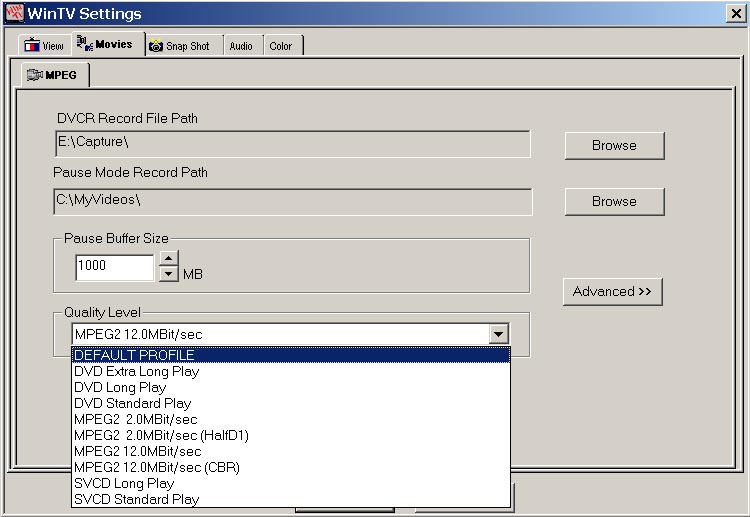

    I installed the 4.8a driver, the 4.6a software and rescanned my channels and now I get all the encode options.
    EDIT: Notice the "Advanced" button that was not there before.

    I forgot to mention that I installed WinTV 2000 before installing WinTV 6 which is probably why I'm getting the encode options. Installing WinTV 2000 after installing WinTV 6 will probably not work.
    EDIT: I just opened WinTV 6 and I'm back to one encode option again, DVD 2048 bytes and the "Advanced" button disappeared.
    Wait, I changed the channel to analog cable 3 and all the encode options are back (wonder if that was the case all along). I had it set to OTA digital channel 12 which captured at 17.9 Mbps and 6 channel AC3, not DVD 2048 bytes.
    Analog channel 12 captured at 6000 Kbps in 12 Mbit/s mode and 8000 kbps in DVD Standard mode. Looks like the tech was correct about the 1800 not being able to capture 12Mbit/s.
