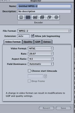

You can also set the field dominance in your Mpeg-2 Setting in Compressor.Originally Posted by Huntr777
You'll need to create a new Mpeg-2 setting, which should do anyway, becasue
Apple's out the box cookie cutter settings don't always take into account
varying source material and or effects.

Apple support only talked as … an after-sales service (they propose to you to eleminate a lot of informations in your source file to avoid user concern
So no deinterlacing,
just change field order from lower to upper in your project setting (see terry post)
...and next time, use a soft that is able to correct field order during conversion of your footage to DV (MPegStreamClip for example)
