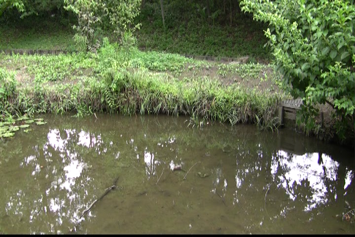

Wow, those are some crazy differences. What is x264 trading off at AQ 1.5?Originally Posted by poisondeathray
aedipuss:
(caveats: aedipuss's frame isn't the same as the one PDR used, the preprocessing is different, the snapshot is a JPG, and the bitrate is much higher.)
I lanczos-resized in Irfanview to compare your snapshot with PDR's. The MPEG2 CCE snapshot is a lot more blurry than x264, but it doesn't smear out shadow detail like Adobe Media Encoder does. Still, it's at a whole 6Mbps while the H.264 decoders are at 1Mbps.
aedipuss's CCE MPEG2 screenshot, cropped and resized to be more comparable, PNG
I really doubt CCE can turn out anything close to H.264 at low and medium bitrates.

True. We should have been comparing at high-bitrate.Originally Posted by aedipuss
I compared using your new screenshot, and x264@1Mbps is still a bit better. I'm willing to attribute part of the difference to better preprocessing (deinterlacing, resizing) for the x264 shot. -
I was just saying that it wasn't a fair comparison since the preprocessing was different. Ideally everyone should work from the same preprocessed source.Originally Posted by aedipuss

Guys, the park/pond clip was only meant to illustrate the effects of AQ. MPEG2 was never meant for low bitrate encodes. But HCenc has AQ ported from x264, it's just not as effective. Here you can see the effects of AQ using HCEnc. The key areas are to look at the shadow detail, and pond/underwater detail.
HCEnc 2Mbps AQ=0
HCEnc 2Mbps AQ=4
Wow only 2Mbps and it looks "passable right?" Wrong. Broken record time: You have to look at the entire clip. The beginning sequence where there is tree/leaf movement is a mess.
HCEnc 2Mbps AQ=0
HCEnc 2Mbps AQ=4
x264 1Mbps AQ=1.5
CCE is much worse at low bitrate (but arguably better than HCenc for high bitrate encodes)
You also have to examine the other frames in the clip, because AQ redistributes bits inter-frame as well. There is not much at AQ=1.5 being traded off in this scenario, but if you look at AQ=2.0 (I didn't post this but you can test it yourself), there is even more improvement over AQ=1.5 on that sequence, at the expense of the beginning scene, before the pan down (the tree leaves are slightly less detailed). So again , everything exists in a balanced range and it's usually up to you to find the "optimal" setting.Wow, those are some crazy differences. What is x264 trading off at AQ 1.5? -
