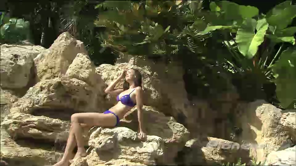

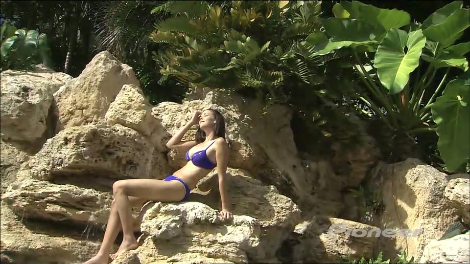

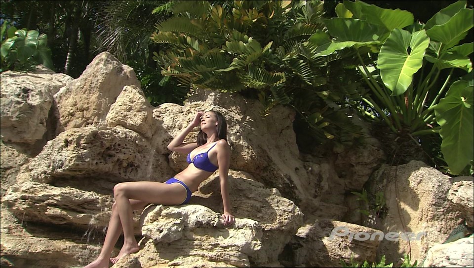

  20. I just got around to viewing deadrats' MainConcept h.264 encoded "bikini" video. Is it just my system or is this video completely screwed up? About the time you get to the bikini shot there is a strobing of low extra low quality about once a second.
    PDR's FFV1 source (VirtualDub):
    Same frame from DR's version (AviDemux):
    Next frame from DR's version (AviDemux):
    Levels differences may be because of the different decoders.
  21. Originally Posted by jagabo
    Confirming this on my system. I encountered it but I didn't say anything because I thought it might be VLC messing up. The pulsing continues through most of the video and there's no sound(?).

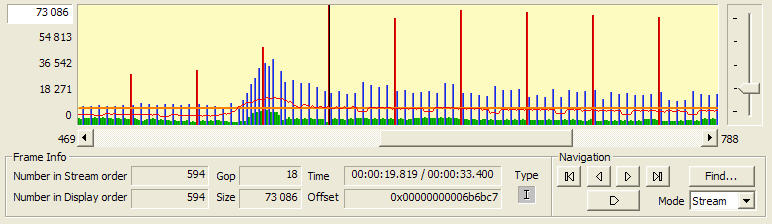

  22. OK I looked at his MC video. He used poor settings, so it's not representative of MC's potential
    1) No b frames. Major loss of efficiency
    2) 1 reference frame. Major loss of efficiency
    3) Short GOP. Major loss of efficiency, especially on this type of material. He used a max GOP size of 33 (which is the MC's default). This is different material than typical trailers with lots of transitions. There's slow pans, and few scene changes. You can gain lots of efficiency by upping the interval and filling them with B and P's
    The strobing occurs exactly on I-P transitions. The "worse" frames are actually low quality I frames, this progressively worsens, as the low quality I frames serve as reference for following P's. The "weight" of I frames are typically higher than others (they should look like peaks), but since his other settings were so bad, they were cut down to fit the bitrate constraints.
    Anyways, I suggest maybe doing some tests at a range, maybe 2.5, 3, 3.5 Mbps. He originally suggested 2.5Mbps, but his encode was done at 2Mbps. I did some tests and 2.5Mbps is fairly low for this sequence, and shows the differences quite easily. The key concept here is, I repeat, test using decent settings. If you handicapp the encoder, you can't draw any proper conclusions from that

    I use Elecard Streameye. It's not free, but if you're serious into this type of stuff, it's a great tool, and provides more information than the ffdshow osd.
    deadrat's distribution. Not there is hardly any fluctation. It's a CBR video.
    a more "typical" 33 GOP size distribution (done on the FFV1 video with MCR)
