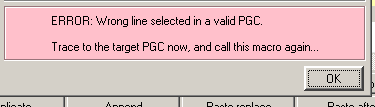

The program says I must trace to the PCG (rather than manually click it) when attempting to select "Jump to PGC upon DVD insert"....
I just am not getting how to do this although I accidentally got it twice and have successfully "repaired" 2 of my problem DVDs.

I will be on the correct PCG but apparantly not on the correct line within that PCG as I get the following message:
So what I do is just...
click step, then try selecting "Jump to PGC upon DVD insert"
if I get that wrong line message, I then...
and so on.
Sometimes if I am lucky I will stumble on the correct line.
I like this program, I just need to figure out this trace feature....Be who you are and say what you feel because those who mind don't matter and those who matter don't mind... -
That's right. Open the Trace and hit "Next PB". Apparently at the time the guide was written there was only a "Step". Doing it that way is useful in order to learn about DVD structure and the command chain, but it's awfully slow. In your case you probably only have to hit "Next PB" twice. It'll stop first at the movie and then at the menu, after the movie finishes. Don't hit "Next PB" again to actually see the menu. At that point right-click on the greyed-out menu and "Toggle PGC Pre/Post Breakpoint" so that the menu line turns red. Repeat the Trace from the beginning until you get back to the red menu. Then go PGC->Jump To PGC Upon DVD Insert, followed by saving your work and testing in a software DVD player before burning to disc.Originally Posted by perceptionist
