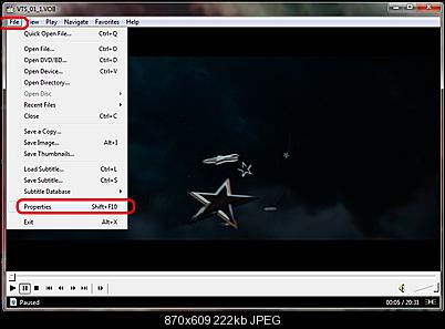

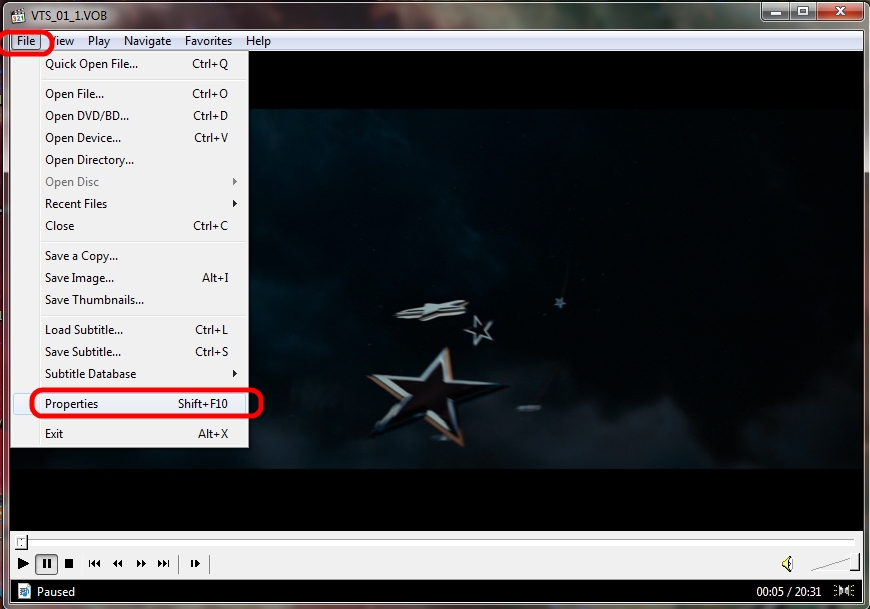

  16. Originally Posted by coeng73 View Post
    I opened the AVI in MPC to determine the delay but could not figure out how to determine it.
    Ok, i was having problems figuring this out.... here is what i discovered.
    1. Open one of the VOB files using Media Player Classic Home Cinema (MPC) and pause the video.
    2. Goto File->Properties

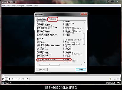

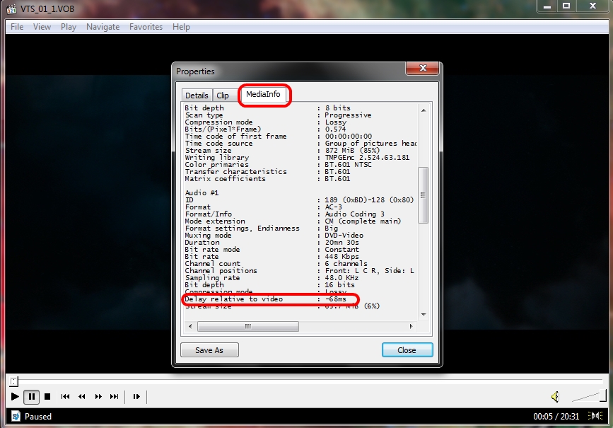

    3. Click on the MediaInfo tab, scroll down to Delay Relative to Video, which in this case is -68ms (milli-seconds)
    Hope that helped someone out... it was driving me nuts !
