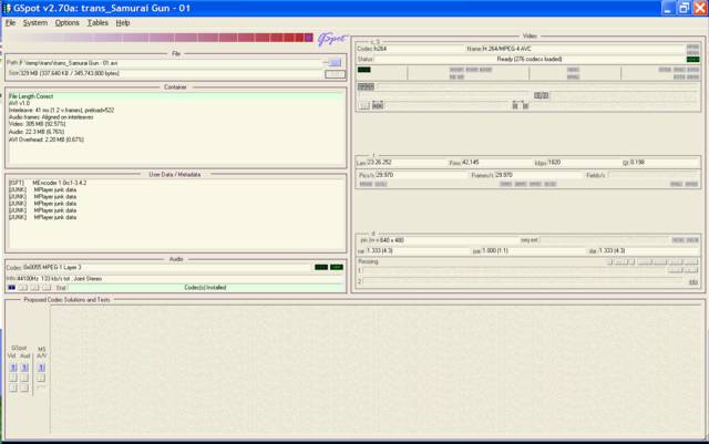

  3. Hello,
    Attached is the g-spot for one I just did. It is showing up as H264
    Thanks for any help..
    I can't even read that, it's too tiny.
  5. Looks like h.264. Switch to Xvid or Divx.
