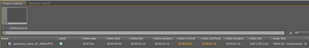

premiere pro cs4 correctly identifies the video without having to "interpret footage as". vegas pro 9 unfortunately can't use the video correctly because it won't allow the files framerate properties to be changed to 29.97
