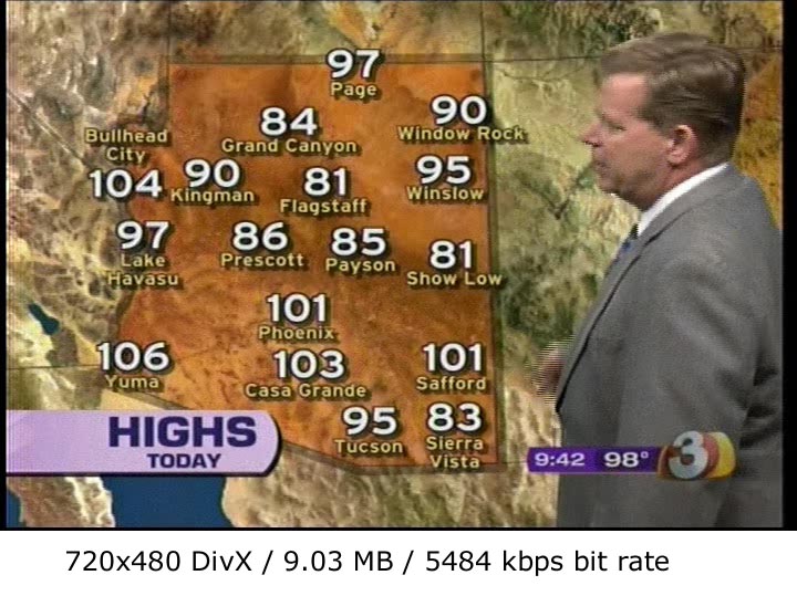

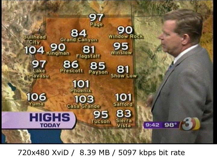

    I did a little more experimenting. I took a 30 sec clip and compressed it several ways. Then I too the same frame from each clip and compared them for quality. I used this frame because there was something very close to the camera and something very far away. Based on the pictures I found that XVid produces a better quality even though it's slower. The filesize diference between XVid 3 and Xvid 4 was about 10 MB for a 30 second clip. DivX definately seems more blotchy to me. Even DivX preset 10 (best quality) looks worse then Xvid 3 and 4. And just for fun I did Xvid 31..wow that is horrible LOL
    DivX Home Theater Profile Preset 2
    DivX Home Theater Profile Preset 3
    DivX Home Theater Profile Preset 4
    DivX Home Theater Profile Preset 10
    XVid Preset 1
    XVid Preset 3
    XVid Preset 4
    XVid Preset 31
  9. You need to change the quantizer in Divx, not the Preset. When using Divx in quality based mode the Quantizer determines the picture quality. The Preset determines how hard the encoder works to get more compresssion. Ultimately, the higher the preset the smaller the file -- for a given quantizer. Presets above 6 are pretty much useless. They take longer to encode but make very little difference in the final file size.
    In Xvid you are changing the Quantizer, not the Preset. And the effects are the same: The Quantizer controls quality, Preset controls file size for a given quantizer.
    Nov 2002
    Now encode with the DivX codec and use the settings that I described. Nobody said anything about using presets. Of coarse XviD is going to look better at a Quantizer of 2 compared to a DivX preset. If you're not going to use a quantizer of 2 with DivX then up the bitrate to match the XviD instead of default 780kbps.

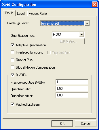

    OK....I didnt know the difference between Quantizer and preset. I did what was posted in the screen shot for DivX and used these settings for XVid
    Xvid Still Looks better...but the file size is much larger for Xvid...

    Here are the 2 new images
    DivX Quantizer 2
    XVid Quzntizer 2 (Settings from screen shot)

  14. Does your version of Xvid have the Adaptive Quanization option on the Profile @ Level -> More dialog?
    If not, you should get one that does and use the feature.

    I'm using Adaptive Quantization.

    I used XVid, clicked Load Defaults, changed Target quantizer to 2, unrestricted profile, Single Pass and got this in MediaInfo
    I used XVid, clicked Load Defaults, changed Target quantizer to 2, unrestricted profile > clicked More and checked Adaptive Quantization > Single Pass and got this in Media Info

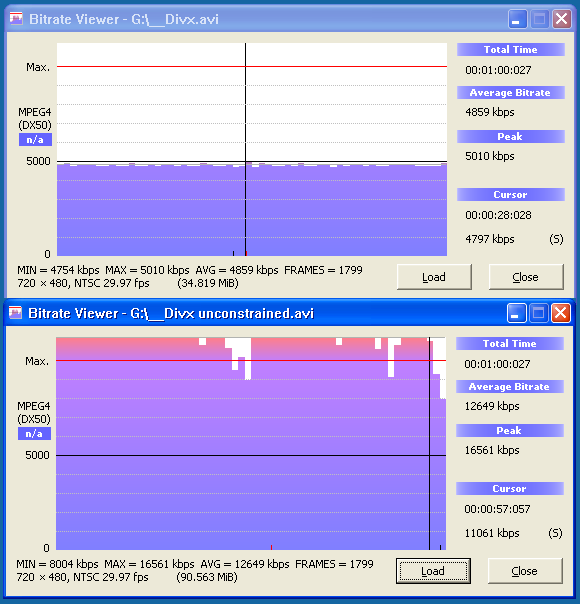

  17. In Divx the Home Theater profile caps the bitrate, even in constant quality mode. Xvid doesn't. That is why the Xvid file has a much higher bitrate compared to Divx. Use Divx's Unconstrained profile if you want true constant quality output from it.
    Open your videos with Bitrate Viewer. It will show you a graph of bitrate over time. I think you'll see the bitrate of the Divx file is pegged at 5 Mbps for the whole video. The Xvid file will have a 14 Mbps average with even higher peaks.
    Bitrate Viewer display of Divx (from DV AVI) at quantizer 2. The top is with Home Theater profile, the bottom is with the same settings except Unconstrained:

    So this is why the quality of the Xvid look much better then the DivX...If I change the profile of DivX to Unconstrained I be able to truly compare Xvid and DivX to see which one suits me better?
    Ok It looks like i am finally comparing apples to apples. It still looks like Xvid is the way to go for me. It produces a very similar quality video at a smaller filesize

  24. The file sizes may be the same but Xvid at Q=2 is better quality than Divx at Q=3. Look at enlarged still frames -- especially in dark areas.
