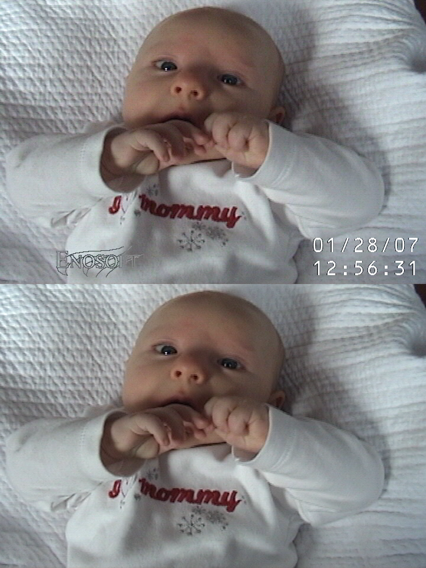

    The main issue with Enhanced DV Decoder for me now is that video decoded with the Decoder has visible artifacts not seen with the default MS DirectShow DV codec. I can post some screen captures for comparison if anybody would like to see. It would be great to combine the speed and features of the Decoder (which otherwise is a great program) with DV decoding by the MS or another better DV codec, or simply by whatever is the dedault DirectShow or VFW DV decoder on the computer.
    Please do post some examples.

    John (regarding Enhanced DV Decoder): Please take a look at the attached images for an example of superior video quality of MS DV decoder vs. EDVD. A frame is captured in MPC-HC (without deinterlacing or other ffdshow processing) with EDVD enabled and disabled, the latter defaulting back to the MS codec. These were simple-resized to 200% in IrfanView to closer resemble full screen playing. Look at the baby's forehead, it's much cleaner with MS. EDVD shows a grid (particularly corners) of 8x8 pixel blocks, while MS practically doesn't. While the difference may not seem dramatic on these stills, it is very noticeable when video is played in full screen, where that annoying grid of blocks is seen with EDVD, but is not seen with MS.
