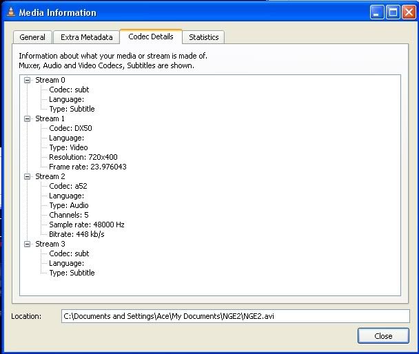

Even though the files should be practically identical (Both around the same size, both play on VLC, both were .ogm and renamed to .avi) the second one just plain won't work on any converter, even though VDM had no problem recognizing it and demuxing the subs and audio. Whenever I try to convert it using TMPGEnc, Authoring Works or no, it crashes the program and when I tried to change the properties of the avi using AVIReComp it gave me an error message claiming my video was not a valid .avi.
http://i297.photobucket.com/albums/mm233/Brunzal/Halp.jpg
Additional information there.

 Don't rename an OGM file to AVI. That is likely to confuse many editors. Renaming an OGM file does not make it an AVI file. They are different containers with different properties and require different handling. Yes, some editors (and most media players) will identify the container by examining the actual content of the file, but I wouldn't count on this.
 VirtualDubMod's OGM support is very rudimentary and outdated. Nearly useless. But if it does work for your OGM file try simply remuxing into an AVI. Video and Audio Direct Stream Copy, Save as AVI.
 Try using AviDemux to remux the OGM streams into an AVI if you need the AVI container.
 Either of those should give you an AVI file that most programs can deal with.
