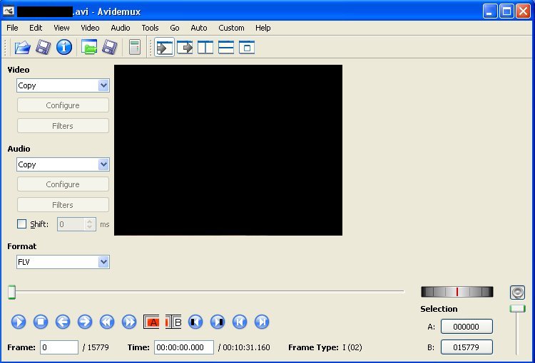

Baldrick, Avidemux seemed the most appropriate program for my task, so I installed it. Unfortunately your tutorial is for a version prior to the current 2.5 and there appear to be many changes to the GUI.
I loaded my AVI file into the program, and it immediately informed me that I need to "Build VBR time map". Sounded necessary, so I chose 'Yes'.
So, now I am lost as to what's next. What settings do I need to convert my file to FLV?
Billarga Website Design - Specialists in E-Commerce, SEO and Hosting
http://www.billarga.com -
If all else fails, I will try that, but first I will wait to see if someone can let me know how to produce the video with a few instructions.Originally Posted by guns1inger
I have my AVI video loaded with the VBR map thingy done.
I have chosen FLV1 from the Video ddm. Changed bitrate to 384 (same as source). GOP size is 100 by default (what's GOP?)
I have chosen MP3 from the Audio ddm. Left all config as default (CBR, 124Kbps, stereo, quality 2, etc)
I want to convert to FLV, so I have selected FLV in the Format ddm.
I click File>Save>Save Video then add the filename test.flv and click OK.
The program promptly vanishes! Nothing...not even an MS debug window asking me to report it to them.
I'm lost.Billarga Website Design - Specialists in E-Commerce, SEO and Hosting
