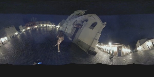

I have been working with a technology that allows me to create videos like this one www.imervista.com.br/demo/rio and www.imervista.com.br/demo/wg7br (full screen) (once the movie starts, click and drag the image)
The movies are captured by our camera and delivered in .AVI format (m-jpeg codec). The source dimensions are 2400x1200, and the bit rate is 29000kbps
Up to this point is fine. video quality is great. but then we have to use final cut to edit the movie and after that we couldn't find a
formula which has a decent performance/quality compared to the initial .avi. The final format I need is either h264 (mov), .flv, or .f4v

5000 bitrate? web streaming?
With dimensions as 1200x600 you need to pump up the bitrate...when i stream videos in MP4(x264+aac) i only use a maximum width of 640 and since aac compresses better than mp3 i use a bitrate of 64, sample rate 22050 stereo, i dont think you need to use 128 for those videos.
I recommend xvid4psp, select mp4 as format, select x264q16 medium profile for video profile and then do a 2 pass encode.
for audio i select the aac-lc 64 CBR profile
Hope it helpsI love it when a plan comes together! -
in final cut pro can you import the source into apple prores 422? if so keep it in that lossless codec to prevent generational losses until you render to flv or mov.
i think if you reduce the size to 720x360 you can get away with a bitrate of around 2000kbps and maintain good streaming quality.
what company made the cam? i like the effect of the 360 lens, but they need to work on the blurring at the convergence of the fisheyes a bit. you have a little editing to do in places to remove the cameraman....
Note that all high compression codecs get a large part of their compression by not including parts of the picture that don't change from frame to frame. So a video like your first one (from a car driving down the street) will require lots of bitrate because of all the motion. The second video (a stationary camera on top of a building) will compress better because most of the frame doesn't change from frame to frame.
5000 kbps with a 1200x600 30 fps video will be pushing it if you have lots of motion. Note also that video static noise is the equivalent of motion when encoding video. Ie, the noise is different in every frame so the encoder will have to waste bitrate on it. -

Another issue you have is the non-linear projection. That eliminates most of the motion vector techniques used in h.264 encoding.
is the file you call final1.mov the source video straight from the cam? it's already in acvhd mpeg-4 with a variable bitrate of only around 4000 kbps, so any further re-encoding to lower bitrate mpeg-4/flv is going to look bad.
no, it is not the original ( the original has close to one 1GB, mpeg, about 40000 kbps). What i called original was just the first one I did... sorry if I didn't explain that beforeOriginally Posted by minidv2dvd
do all the videos look ok when viewed in a "normal" player, i.e. no macroblocking or other artifacts? i downloaded the final1.mov and it looks fine in vlc as a weird shaped video. no visible defects. i'm wondering if the defects are introduced by the 360 degree player, as i would reject all those test videos as not good enough to use.

A 2400x1200 frame, 30 fps, at 40,000 kbps MJPEG is going to be full of macroblock artifacts.Originally Posted by minidv2dvd
are you referring to the original source? he lists it as mpeg not mjpeg.Originally Posted by jagabo
the original has close to one 1GB, mpeg, about 40000 kbps -
His last post listed it as MPEG but his first post listed it as MJPEG AVI.Originally Posted by minidv2dvd
Sorry I misspelled it, It is mjpeg (avi containter) not mpegOriginally Posted by minidv2dvd
You might try using a deblocking filter on your MJPEG source. Deblock before resizing and compressing.
Oh, and when you resize different algorithms can make the video easier or harder to compress. Bilinear or Precise Bilinear will be easier to compress (not quite as sharp, less high frequency noise), Bicubic or Precise Bicubic will be harder (sharper, more high frequency noise). Basically, the sharper the resizing algorithm the higher a bitrate you will need.
Noise reduction, both spacial and temporal, can reduce the bitrate requirement.
Here's a short sample after filtering with Neat Video in VirtualDub and encoding with x264 at about half the bitrate:
http://www.mediafire.com/?sharekey=49c752f9633c890caf924764f9977b1dff48a68dab7e8639c95965eaa7bc68bc
This isn't optimal because I started with your already h.264 file. You would probably get much less posterization and overall better results starting with your original MJPEG AVI. -
The videos will look good in a regular player, however, what you see in a regular player would be a "flat" image showing all the cameras at the same time. It looks like a "panoramic image", but with also the images of the sky (top camera) and ground (lower cameras). The addition of the top and bottom images make a "spherical image"Originally Posted by minidv2dvd
So in order for you to be able visualize a image inside of the video frame, the player gets that spherical image and wraps in the obviously shape of a sphere.
Now try to imagine yourself inside of the sphere. The bigger the sphere easier is for you to see things without distortion, because in your view filed you can see all the "edges" of the sphere. Just like our planet. But in the real world, you don't see the edges of the planet, therefore you can't realize the distortions (have you seen those pictures of the earth seen from space? you see the whole planet and the countries seem to be round, just like the sphere which they are in. Which is actually true, but you don't perceive that way, because of the size, gravity, rotation, etc, etc)
So in order to keep everything looking squared and not curved/distorted, the player try to correct this by stretching the image. that causes pixelation/macro artifacts to start to be seen) That's why in order for this technology to come to life in its real potential, the image has to be large enough in size, and/or in really high definition, so even if we "stretch" the image we wouldn't see the artifacts. That is currently done offline on the computers, but for obviously reasons still hard to do over the internet.

Hmmm. It plays smoothly here. Maybe you're having problems because I encoded in VirtualDub (to use Neat Video) as AVI, then remuxed the h.264 stream into an MP4 container. The x264vfw encoder produces slightly odd h.264 streams.Originally Posted by sapojow
Yes, that one will encode down to very low bitrates without problem. Here it is at 1200x600, x264vfw in AVI, about 800 kbps:Originally Posted by sapojow
x264ts5.avi
I used the Lanczos Resize, MSU Deblocking and Temporal Smoother filters. -
That's not the cause in this case. It plays smoothly in "normal" players. When you run it through the Lucid flash player through the xml/html embedded player offline = jerky city. I tested using an older single core computer to simulate "worst case" scenario for possible end users. Some streams that didn't play well on the single core obviously played better on a faster rigs.Originally Posted by jagabo
That modded flash application is nerfed. It doesn't play well with all h.264 settings. Adobe Flash coding is bad enough, but with the extra overhead imposed this is very bad. I encoded several streams and the same video plays fine in other flash player implemenations. (Also the visual quality is dramatically worsened with this player compared to other flash players, everything becomes less crisp, I suppose it's from the warping/wrapping technology?)
This means you have to use lower quality & lower compression settings in order to make it play smoothly (worse compression or worse quality for the same bitrate). You basically can't use AVC High (no I8x8 or adaptive DCT), 1 reference frame max (sometimes I was able to use 2), no b-pyramid, max 1-b frame. For anyone that thinks it's a x264 compatibility issue ; it is not. I tested some streams using Adobe Media Encoder for .f4v streams, and any "higher" quality settings would cause jerkiness. I tested some of the successful streams from your website, and the ones that "play nicely" for the single core were no b-frame, 1 ref frame, avc main. From my quick testing, you're basically stuck with using low quality settings, and compensating by using higher bitrates (which then raises the issue of bandwidth as the bottleneck, because I only did offline testing)
Going the preprocessing route with filtering is a good idea as jagabo suggested, but wow this player makes videos look very bad; and there's not much leeway you can do in terms of optimizing encoding settings. I can't think of any decent solutions here
PS. there's some errors in the source video, there's only about 17sec of valid video frames (more for audio), but it's enough for these testing purposes
