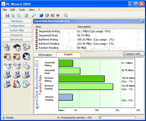

This is not very obvious. I recently upgrade a PC to dual 2.2 GHz CPU with dual channel DDR2 RAM, and still see it stalled.Originally Posted by edDV
I finally throw in a SATA II drive, and the problem goes away.
I have a lot of large PATA harddrive, and use them all over the place, the old PATA drive perform about the same as older SATA 100, or SATA 150 drive. But the new SATA II (aka SATA 300) drive is about three time faster, and do really speed up all the processing, because most applications are so big, that they take many seconds to load. -
This more to do with the data density than the SATA II interface. The fastest 7200 RPM drives are only now approaching the SATA 150 bandwidth, and even then only at the outer edges.Originally Posted by SingSing

This is a benchmark of the 250GB Hitachi SATA HD I bought recently. Installation of XP pro sp2 was completed about 10 minute ahead of time. It is faster than its own 500GB model.Originally Posted by jagabo
