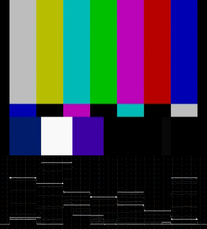

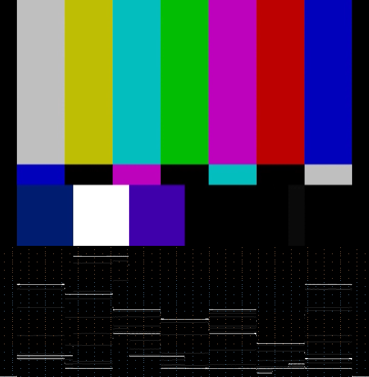

 Contains a link to a small DVD ISO image containing 10 seconds of the Macbeth color chart. Convert that to Divx with AVS Video Converter and upload the result. I'll take a look to see if the program screwed up the levels.
 Here's just the VOB file if you need it: vts_01_1.zip
	The levels look pretty close to normal in your Xvid AVI file:
 And the levels of the source:
 The brightness has dropped a tiny bit bit but that's not uncommon because of the inaccuracy of converting between the YUV and RGB colorspaces.
 If the Xvid AVI file shows much more contrast on the PS3 it must have something to do with the way the PS3 displays Xvid AVI files.

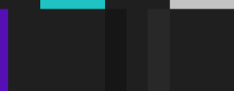

	Can you see the slightly lighter black vertical bar in the lower black section? You should just barely be able to see it. There is also a slightly darker black bar that you're not really supposed to see (it's below the designated full black level). Here's the black test area lightened up so you know what to look for:
 Compare the MPG and the AVI. When viewing the videos the larger black areas should appear completely black on your TV (as black as your TV gets). The darker bar should be the same shade of black. The lighter bar should just barely be visible.
