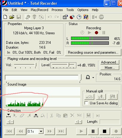

Also, below is a screenshot (see red circle) showing Total Recorder level meter on this audio clip. You can see hard limiting. This is what must be causing the distortion.

I don't understand how you can say that sample is not clipping. Look at the Total Recorder level meter. Normally, you will see the audio display tracking with the amplitude (see below screenshot). In the above case, you just see a horizontal line, no indication of varying amplitude.

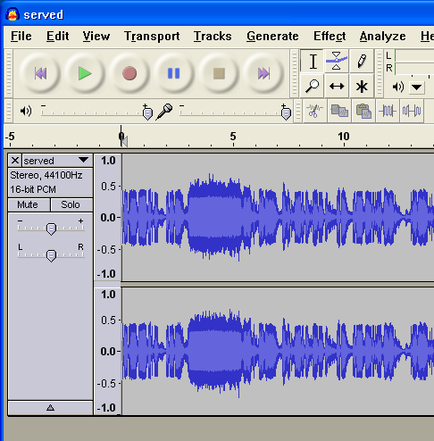

I agree with johns0, that mp3 file isn't clipping but it was recorded from a device that was. In Audacity you can see there's no clipping (maybe mp3 encoding has changed the data?):
I also agree that there's not a lot you can do to fix it. A low pass filter will bring the harshness down a bit. Audacity also has a Clip Fix filter that may help a bit. -
