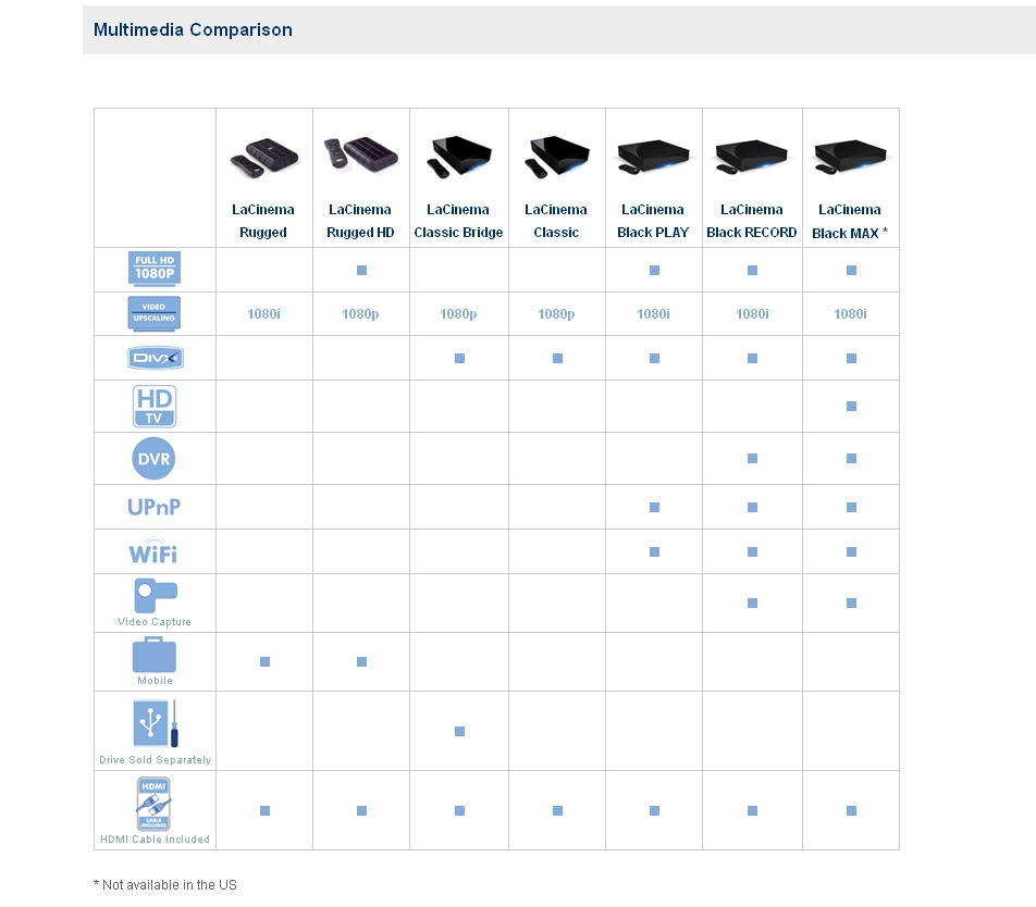

    In the meanwhile if LaCie still interests you check out their multimedia player line-up. I have attached LaCie's comparison on their line-up.
    And if you like you can also check this link. You may find it of some interest.
    http://www.lacie.com/ca/products/range.htm?id=10049

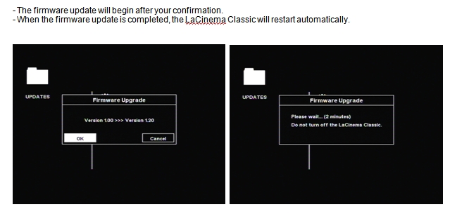

    Help needed please, I got my 1T LaCinema Classic off Amazon UK but live in the Pacific.. long story
    Often while watching movies the movie freezes, to get it working again i have to unplug at the wall and start again.
    Has anybody else had this?
    Could this be a cooling issue?
    The Operating system seems basic, can it be upgraded?
    Any help out there? Thanks
    Aug 2009
    Canada
    Hi Peter:
    I think I had a similar problem, but not exactly the same as yours. In my case while watching some films if I paused any of them I couldn't get the film to continue from that point no matter what I did and had to start the film from the beginning. However, the most recent firmware upgrade has solved the problem (at least I haven't experienced it for quite some time after I upgraded the firmware).
    It is probably a good idea to upgrade the firmware regardless. I am giving below the information/steps to upgrade the firmware because in the first upgrade (1.20) they had instructions, the second upgrade (1.31) didn't have the steps and I had difficulty doing the second upgrade and needed to refer to the original steps to complete the firmware. I hope the text in the graphics below is readable. PLEASE MAKE SURE YOU DO BOTH UPGRADES IF YOUR LaCinema Classic does not have the first upgrade. Otherwise the second upgrade will not work. Good luck!!
    1. Go to www.lacie.com
    2. Go to the “Multimedia Hard Drives” section.
    3. Select the LaCinema Classic.
    4. Select the “Support” tab
    I may have to do separate posts because I am having difficulty uploading the images in this post. I am probably doing something wrong but......

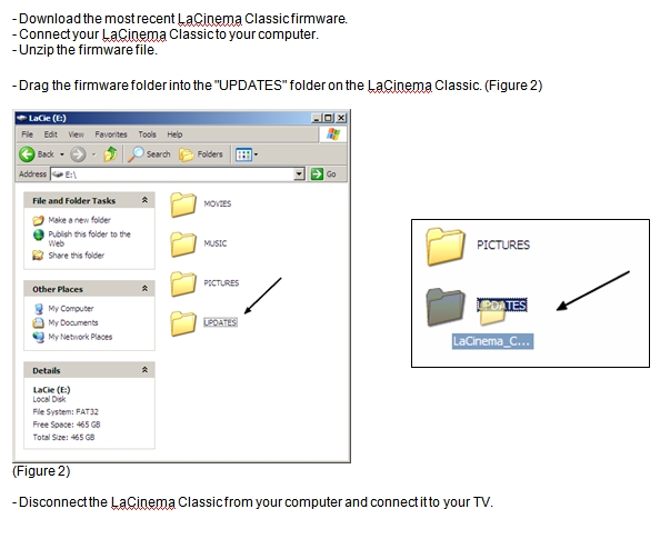

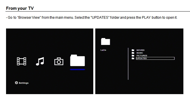

    There are a total of four graphics showing the steps here they are:
    Aug 2009
    Canada
    This is the second step.

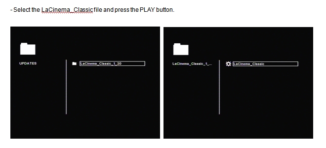

    This is the third step
    Aug 2009
    Canada
    The step below is the last step . Good luck!! You may need to zoom into the graphics if they are not readable.
