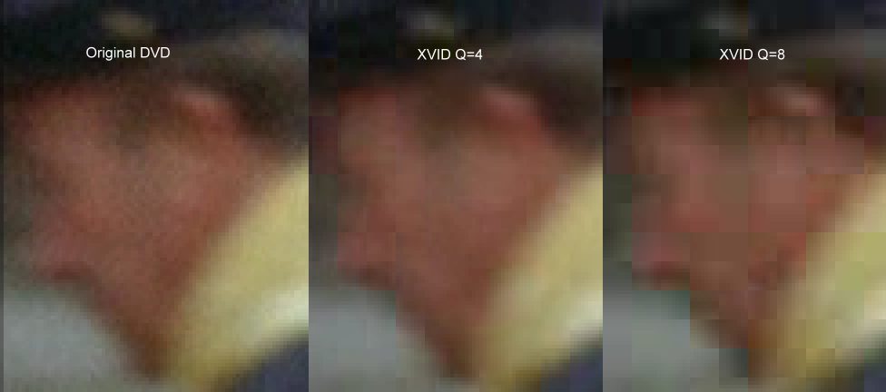

	I only have one question about XviD's qualitizer.
 When I set 4.0, it works good for three color shows that I record. It sets about 150-175 for a 22-25, about what the Internet standard seems to be.
 Yet, when I try and convert basically the same length show in B&W, suddenly it tries to make the video around 350 for 22-25 minutes, so I have to make it 8.0.
 4.0 vs 8.0 seems to really have no impact on the quality, but I always thought B&W would result in a smaller file at a higher quality, but obviously I have seen evidence to the contrary.
	I suspect the latter film had a lot of film grain noise. Noise makes video difficult to compress.Originally Posted by RedPenguin
 There is a big difference between Q=4 and Q=8. Open the videos VirtualDub. Right click on the left pane and zoom in 400 percent. See all the huge macroblocks in the Q=8 video? The Q=4 video will have less macroblocking. The original video even less. Here's an example of a fuzzy background from a grainy old film enlarged 4x (nearest neighbor) with Xvid's playback deblocking disabled:Originally Posted by RedPenguin
 In my experience B/W and color are about the same in compressibility.Originally Posted by RedPenguin

	It's up to you: Live with a big file or a low quality file. Or try a quantizer between 4 and 8 as a compromise.
 You can also try using Neat Video to reduce noise. That should bring the bitrate down. Or a combination of 2D Cleaner and Temporal Smoother.
 Oh, and be sure to use Xvid's deblocking filters on playback.
	There is your problem. You want to have a small file and you cannot have a small file without having terrible quality. I myself would never use a quantizer higher than 3 but I only care about quality and could give a crap about file size.if I try and use 4.0 qualitizer of either DivX or XviD, it attempts to make the size 350mb+, but if I go down to 8.0 to get it within the size I want, it makes it horrible quality.
 You have to make up your mind what you want, good quality or small file size. You can't have both.
