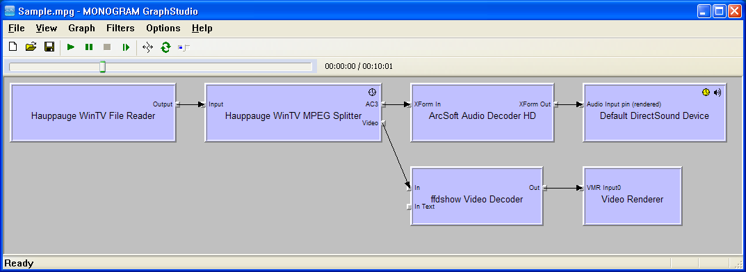

	Like I said, when you use DirectShowSource() you're at the mercy of the DirectShow components you have installed. You can try using GraphEdit or GraphStudio to see which filters are being used to play via DirectShow. The latter gives more information.
	Thank you, I forgot all about those two programs.
 It looks like I solved my laptop, all I did was uninstall ffdshow, reinstall it telling to reset all settings, then put mpeg2 back to libmpeg2, and all is well.
 Now I still gotta find out why my desktop skips part of the video, but it looks like my laptop is all ready to go.
 Thank you so much again, for all of your help, I was so ready to just give up and delete the recordings, but now I finally can get to converting instead of troubleshooting.

	Graphedit really helped me out.
 I found out that my laptop was using MainConcept MPEG Demultiplexer while my Desktop wasn't.
 MainConecept doesn't skip that part of the video but for some reason can't keep the A/V sync.

 EDIT: I may have fixed it using MPEG-2 Splitter instead of MPEG-2 Demultiplexer.
 Wow, these are definitely the hardest to convert videos I have ever seen. They are worse then copyright-protected or something to that nature.
 EDIT #2: FINALLY! Looks like that definitely did fix the problem, it is no longer skipping parts of the video that it was skipping before.

 Something really strange is going on, the only one who keeps the A/V sync is MPEG-2 Demultiplexer but it gets clogged and sometimes when two segments meet, you will get overlap, where you will see a second of the following video before the current video and it just freezes.
 I think I will have to try and see why the others just don't want to A/V sync like MPEG-2 Splitter.
	I tried setting various filters/splitters/what have you to go in front of MPEG-2 Splitter and Demultiplixer and nothing seems to want to work.
 I eventually got Hauppauge Splitter to open but not File Reader.
 I think I'm running out of options again.
 Figures I finally get the A/V synced but now parts of the video are skipped. Uhh....
 EDIT: I'm STUCK at it skipping minutes of the video, even though A/V sync is fine through out the entire video.
