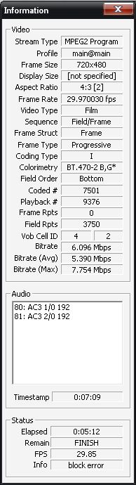

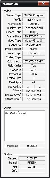

	Hey guys it's me again. I have a DVD that I am starting and there are 4 VOBs. The first 2 are interlaced 29.970 (DGIndex told me) VOB 3 is progressive 23.976 (DGIndex told me) and the last is interlaced. I ran each VOB individually thru DGIndex to check them. Is this common? Would I save the project using Force Film since midway thru the frames are progressive? Would this be an example of Hybrid footage? I really do appreciate the feedback I get from you guys. Thanks
	I'm assuming all the VOBs belong to the same movie. Open all the VOBs at once and make the entire project using Honor Pulldown Flags in DGIndex. Open your unfiltered .avs in VDub(Mod) and have a look. If they all have the same pattern (3 progressive and 2 interlaced frames in every 5 frame cycle), then use TIVTC with settings something like this:

 Again, assuming these VOBs are all from the same movie, I find it a little hard to believe that 3 of them are all completely NTSC and one is completely FILM. You could upload the D2V for us to have a look.The first 2 are interlaced 29.970 (DGIndex told me) VOB 3 is progressive 23.976 (DGIndex told me) and the last is interlaced.
	Yeah, all VOBs are from the same DVD. I previewed each VOB in DGIndex for little over 5 minutes each. VOB1 is Interlaced and VOB2 is progressive Here is the DVD I am talking about

 I loaded each of the 2 VOBs in VDM and VOB1 every 5th frame has interlacing and VOB2 didn't have any. I even moved through the entire VOB and nowhere did I see any interlacing.
