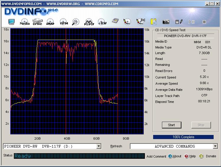

	Here's a odd looking scan
	^^^ That sure is a odd scan.....but remember that scanning isn't accurate with Pioneer drives. If you've got a old/newer liteon, benq 1620, 1640, 1650 or the newer samsung drives those are the recommended drives to use for scanning discs.
 I haven't done any scans in a long time. Yuh, those freaks got me into scanning as well a few years ago. Pioneer drives are good burners. Too bad Benq sold out their optical dept. to Liteon.
	Remember it's just an RPM scan...I don't do that other PIO OI IO shake what not stuff. In most cases a verify works fine for me.

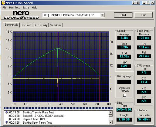

 I'm doing an RMP test with DVD Info right now to see what it comes up with
 With my old (now just replaced) NEC 3540A, the RPM would always increase to the end.
	OK I've heard of the bell curve, but this is just plain wacky for a RPM test
 DVDInfoPro v3.43
 I'm doing another RPM test on the disc using a firewire drive I have
	Still darn strange looking to me.
 This burner is connected via firewire
 Same bell curve
	oh, it's in a external case that could be why the scans are odd.
	No the last scan was external firewire. the others are from the New internal Pioneer.

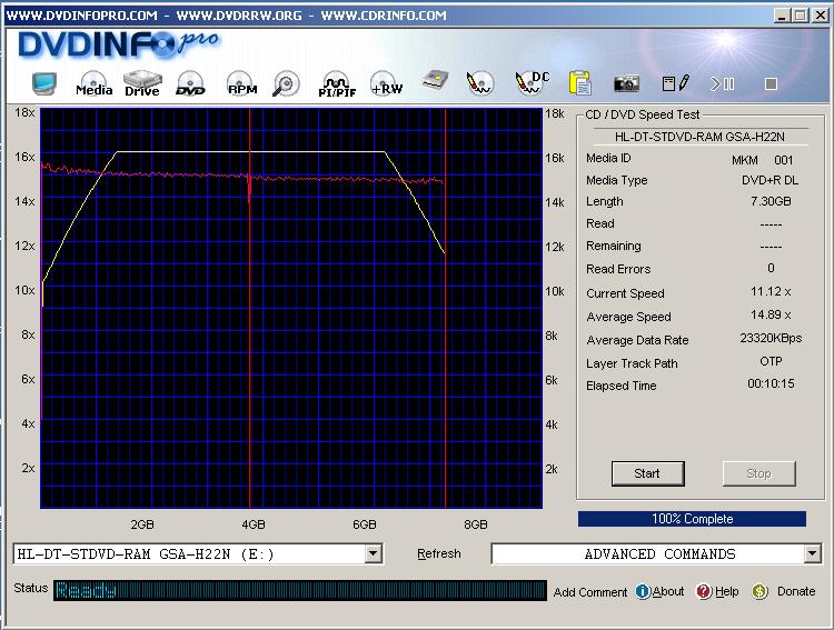

 My NEC 3540A was starting to show it's wear and tear on DLs, so I started doing all my DL burns on my external, until I picked up this new Pioneer.
 I got other internal drives i could test this on too.
 Lets see if that box is still bootable
 In this box I have an old BTC 16x (my BY FAR and AWAY best problem disc reader) and a NEC 3550A
