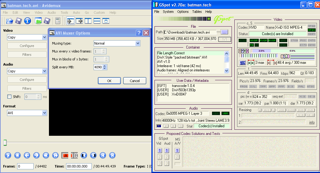

    So now that I have the audio "fixed" the way I want it, what's the best way to join it with the video again? Is there a tool that works better than others? For example, I tried to make this work with Avidemux, but I'm not sure that the way I did that was correct — or the most efficient way.
    In Avidemux, I opened the AVI file again, went to Audio > Main Track > Audio source and selected "External MP3" to select the edited MP3 file. After that, I did Save > Save Video, and I think it worked. Somehow.
    My biggest problem, right now, is that the original audio was a little bit out of sync with the video. There is probably a name for that. What's the proper thing to do to adjust the audio with the video? Is that what you call MUXing? What values have to be adjusted by how much?
    I guess, I could look at the AVI settings with GSpot and find out all kinds of things, but I just don't know what I need to look for and how to calculate the offset (or whatever it's properly called).

    I explained in my last paragraph above how to add the edited audio back in. As for it being out-of-synch, assuming the amount is constant (off by the same amount all the way through), when you add back the audio, right-click it and go into interleaving. By adjusting the audio skew you adjust the delay. 1000ms=1 second and setting a negative delay causes the audio to play earlier, a positive one, later.
