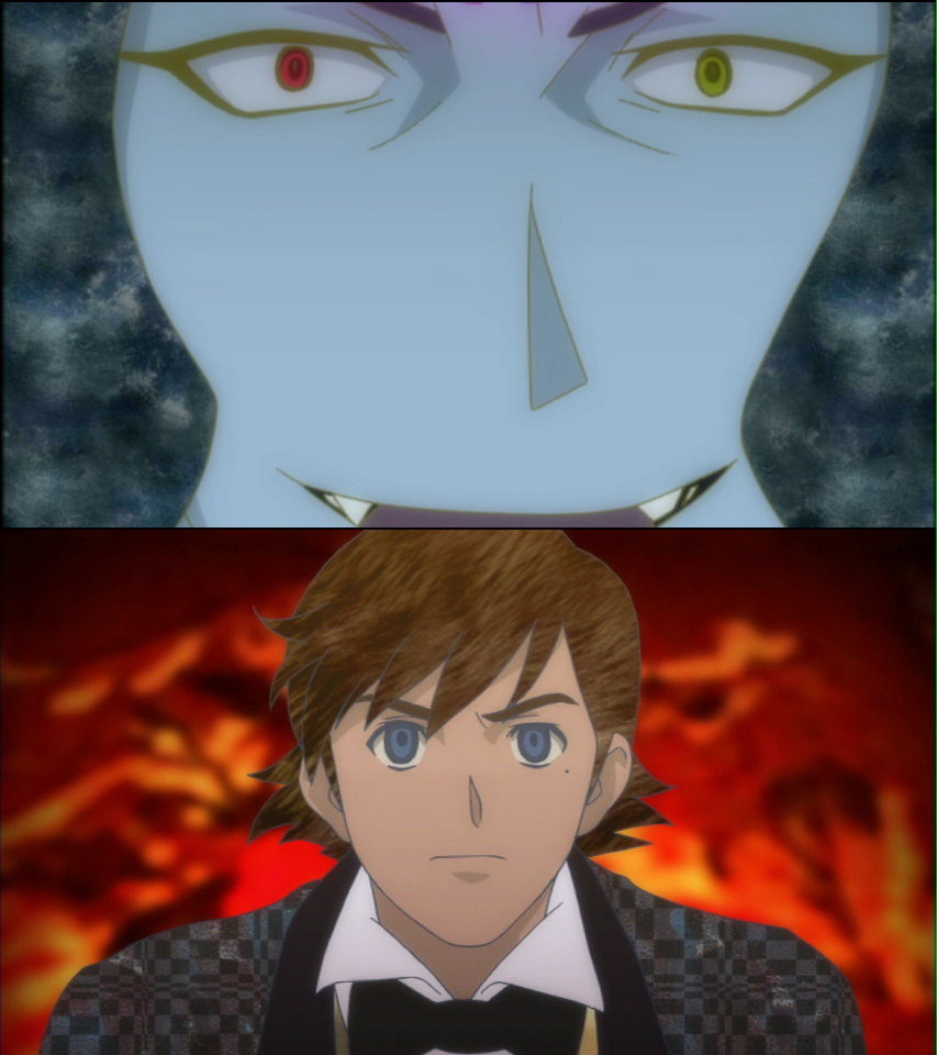

    This is original "source" material from a DVD.
    Now I guess everybody can see those stripes. Does this mean that the bitrate is too low (vary from ~4500kbit/s - 6750kbit/s)?

    What stripes? In any event, to learn if the bitrate is high enough run a VOB through Tecoltd Bitrate Viewer
    and check the Q Level. You'll have to search in the tools section under that name, because the link takes you to a different one. If it's below 7 or so the bitrate is high enough. I see no evidence in the pics of the bitrate being too low.

    Converting from DVD to what ?
    Are these stills from the DVD ?
    Are the bands across the face visible in the footage, or only if you flick through frame at a time ?

  4. I don't see any lines either!
    edit: When I tilt the screen I can.

    Yet, it's not about encoding at this time.
    Yup, this is a still but they are still visibled when watch the DVD normally.
    Are you all using TN-Panel displays o.O?

    I can see horizontal bands across the face in the top image, and some mild bands in the bow tie of the bottom image.
    I would like to see a few seconds of the original footage from the top image to see what it looks like.

    I see the bands as well, in both stills. Looks like an analog transfer.
    Too low of a bitrate would cause macro blocking and mosquito noise.

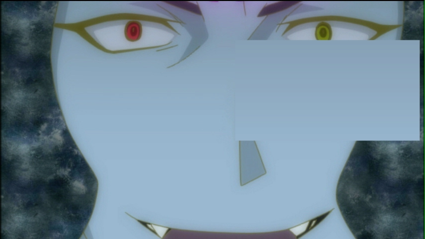

  9. Given the bands are perfectly horizontal I suspect this is more from limitations of 24 bit color. The original animations were created on a computer using a gradient fill (in the faces) from top to bottom. When you perform that type of fill between slightly different shades you will get a little banding like that. This is because you can see the difference between two adjacent color like (R,G,B) 147,177,201 and 146,176,201 (colors taken from the top image in the provided sample).
    On top of that you have the conversion of the original RGB to YUV when converting to MPEG and back to RGB for display which introduces more banding (not every color in the 24 bit RGB space resolves to a unique color in the 24 bit YUV space, and vice versa). And finally the DCT precision used in MPEG encoding can introduce even more banding.
    This is why a little noise is your friend.
    One of the images with a block of gradient fill using similar colors (24 bit RGB):
    You can see a little banding in the gradient fill. If you examine the RGB values you'll see that the color never changes by more than one unit (in each channel) as you move from top to bottom in the filled area).
    The same image converted to YV12 and back to RGB in AviSynth (as would happen when converting to MPEG and then displaying again on an RGB display):
    You can see even more banding now.

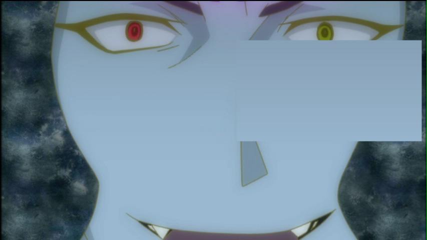

    Finally, here's the RGB gradient fill with a little added noise:
    And the same image after converting to YV12 and back to RGB:
    The banding is has pretty much disappeared in the gradient filled box (the original portion of the image is beyond repair).

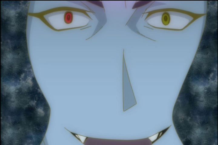

  18. The DVD frame size is 720x480 but the display aspect ratio is 16:9. So media players stretch it to 853x480. This is fine for viewing but not for analyzing fine details of the video. You should use an editor like VirtualDubMod to open a VOB file, then save a frame as PNG via Video -> Snapshot Source Frame.
    Feb 2009
    Germany
    Sure, how could I forget this >.>...perhaps I just naively thought they would treat it better due to it's unique pattern properties.
    But here it is
  20. I doubt you'll find any source significantly better than that unless there's a Blu-ray version.
  21. This type banding commonly occurs in anime when grain remains before heavy denoisers are used. Not a good quality source.
    You can try GradFun2DB() or one of it's derivatives (e.g. GradFun2DBMod). It's commonly used for anime banding. You can tweak the parameters, but definite improvement in this banding even at default settings. Read the included documentation for more info
