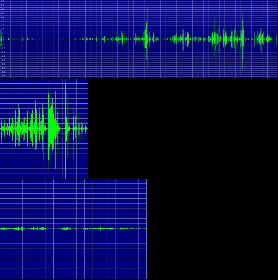

    These pictures are from GoldWave. From top to bottom, they are the sound file as a whole, a loud part, and most of the rest of the file. This is the original audio, before doing anything other then working with it as a wave.

    Normalizing just raises the highest peaks of your entire audio to maximum decibels without clipping - it doesn't "equalize" the volumes across the entire wav. So "softs" are still soft and "louds" are still loud. It's just all shifted up higher, as high it can go without the highest/loudest bits clipping.
    What you want is compression.

    Well, trying that doesn't do much. At best I get a .5 db change.

    In goldwave did you try effect/compressor/expander/boost quiet parts?
    Jun 2007
    Yes, but again it becomes muffled. No clue as to why, as I am not changing anything else, and if boosted manually there is no issue.

    Tweak your compression settings. Use a higher ratio, like 4:1 or up.

    Thanks Everyone. I used Goldwave to edit it in the end, but it's a lot better.
    I had to use a ratio boosting the quiet sound by 300%, run the reduce peaks, and finally normalise it again.
    Nothing got muffles, loud parts are still loud, and the low parts are at a good volume range with clarity.
