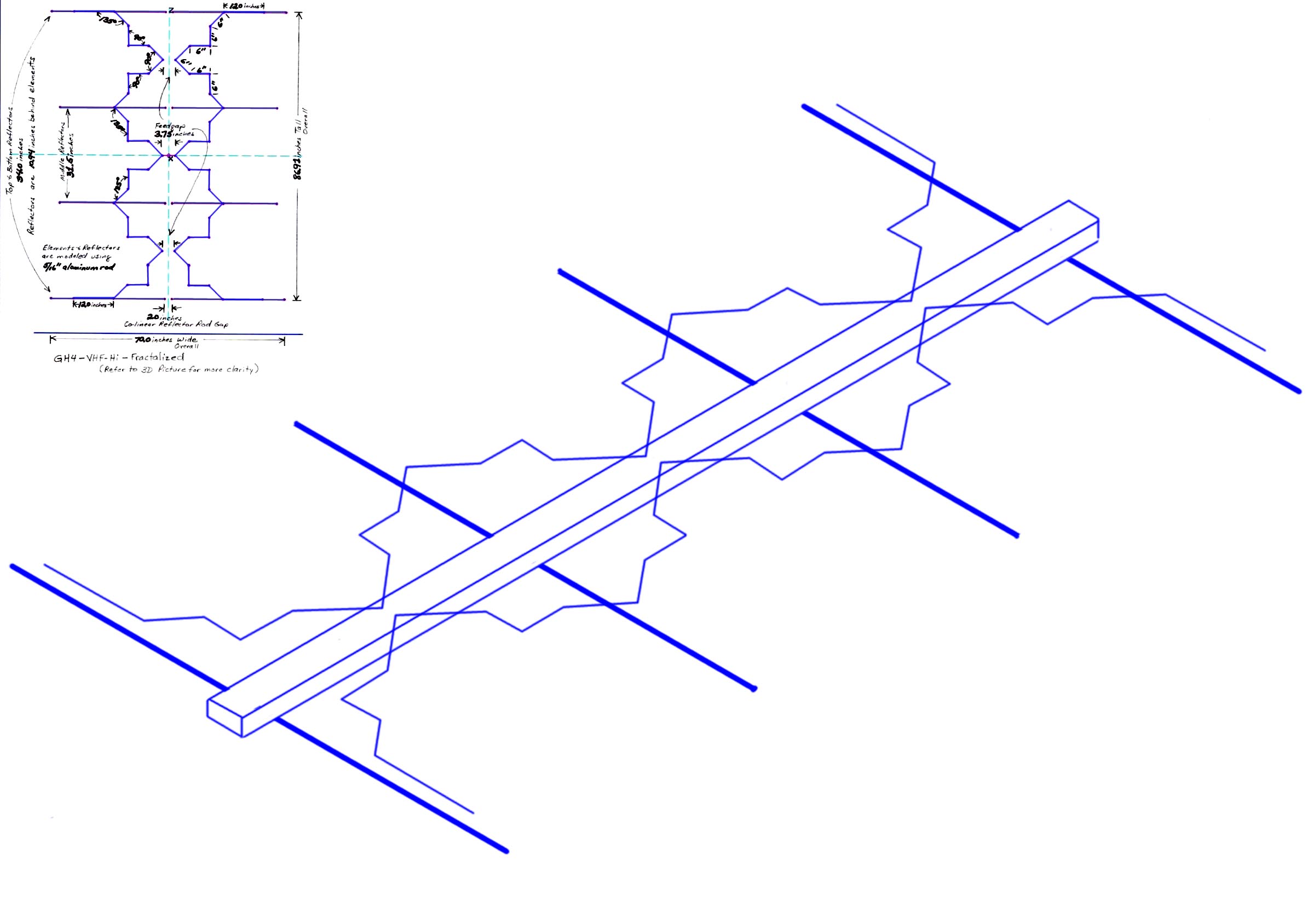

	I took my homemade indoor UHF antenna apart and replaced the ground wire (was using speaker wire) with a thicker solid copper wire and am now able to get all of my channels except for FOX 10. Could not get any PBS channels before but am now able to get 8-1, 8-2, 8-3 and 8-4.
 WinTV's Digital Signal Monitor shows all of my channels with a Signal to Noise ratio of at least 24 except for PBS and NBC which show 15 to 20 SNR. The signal works fine above 17 but is choppy when drops below that. FOX 10 shows no SNR at all.
 Hopefully after August 30th (when FOX is supposed to have their antennas fully operational) I'll be able to get FOX 10 also.
 What pisses me off is that the Philips powered UHF/VHF antenna that I paid $35 for will only pick up a handfull of channels while the 2x4 and wire attached to it picks up 25 channels. I live in a stucco house with foil insulation over the windows about 23 miles from the antennas in Phoenix.
	How do you construct a home made UHF antenna with 2x4 and copper wire ?Originally Posted by DarrellS
	http://www.youtube.com/watch?v=EWQhlmJTMzw
 Here is a pdf of the same thing
 edit these things should only pick up uhf and not vhfDonadagohvi (Cherokee for "Until we meet again")

 I made a similar two bow tie UHF antenna out of a pizza box.
 https://forum.videohelp.com/topic369371.htmlRecommends: Kiva.org - Loans that change lives.

	I put aluminum foil on a 1/4" thick piece of pressed board an tacked it to the back of mine and lost a few stations. That was before I rebuilt it with better ground wire so I don't know if it would help or not. Mesh would probably work better.Originally Posted by SingSing
 I drew these plans up from a drawing I found on the net. The guy had a smaller version tied to a big piece of cardboard with bread ties.
