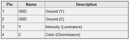

A S-video pinout: http://pinouts.ru/Video/SVideo_pinout.shtml Also look in Wikipedia: http://en.wikipedia.org/wiki/S-Video

There are many plugs found on electronic equipment and cables that at first glance have similar features (round, holes, pins) to that of svideo.
Could it be that you mistook a power connector on one device or the other for an svideo plug. As described before, the most common consumer svideo type has 4 pins with a plastic key hole/pin for support and to aid insertion. This is most likely the one on your equipment. Check your devices and see if that is what you have. If not then it might be a power connector or some kind of powered device port. Even if it's not fully inserted but is just touching the metal leads it would cause sparks like you describe. Although you can't discount a very dangerous live wire shorting on the ground, I would tend to believe that explanation before a peculiarly timed equipment failure.There's not much to do but then I can't do much anyway. -
