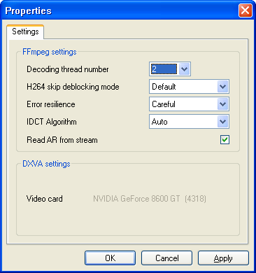

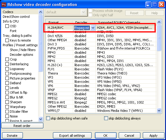

  7. Make sure you have a recent (last six months or so) ffdshow with a multithreaded h.264 decoder. Older versions were single threaded.
    If you use MPCHC's internal h.264 decoder make sure the number of threads is set to 2 for a C2D CPU:
    And as suggested earlier, you can try using the DXVA decoder in MPCHC to have the GPU to do the decoding.

  11. ok the h264 filter was already set to 2 theads. do i just tick all filters? some arent ticked

  16. i followed the ffdshow video configuration exactly.. followed the video also, configured with avisynth plugins etc etc, just didnt do reclock configuration or anything as only have stereo sound.

  22. i havent really changed much in ffdshow video decoder config, ive changed the rhb conversion, the output options, resize aspect ratio, luma method and luma blur, and avisynth, and changed the avisynth, raw video and mpg2 codecs.. it all seemed logical as i was following the guide.. ill double check again to make sure.. with the avisynth i put in some setmtmode code option.. i dunno here what to do as everything else plays perfectly...
