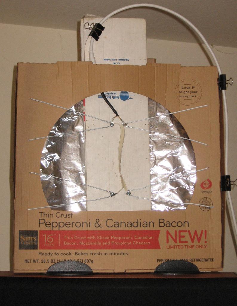

    I'm in a DTV hole here with a ridge blocking Sacramento and San Francisco stations behind me and hills limiting reception of distant stations to the northwest. I purchased a DTV converter box anyway and started experimenting with simple rabbit ears and UHF loops. To my surprise I was able to pick up a translator on Sutter Buttes ~55 miles distant and ~1000ft below me. The channel 58 signal strength was intermittent at 0-35% so I decided to build something more directional. The Pizza box antenna shown below was an immediate success with solid 45-65% on the meter. On Friday the translator switched to channel 28 and signal strength jumped to 89-100% depending on weather conditions. This just shows that line-of-sight and antenna height are important for distant reception. The converter box is a Channel Master CM-7000.
    List of materials
    1. Sam's 16" pizza box (eat pizza)
    2. 16"x16" aluminum foil
    3. Cardboard or wood 2x4 16-20" long
    4. 4x coat hanger pieces clipped to 14" and folded into > <
    5. Piece of twin lead folded
    6. 300 ohm to 75 ohm coax antenna balun
    7. 75 ohm RG59 or RG6 coax cable
    8. 3x paper clips
    9. 4x wood screws (don't hit the foil, file off coat hanger paint at screw point)
    And most important to make it stand up
    10. 2x feet from external hard drive enclosures

    I should have mentioned this is for UHF reception only. Also you need to file paint off at the coat hanger V screw connection point. I made additions above.
    I would have made it look nicer if I thought it would work
    It points out a west facing window behind a curtain so nobody sees it anyway.

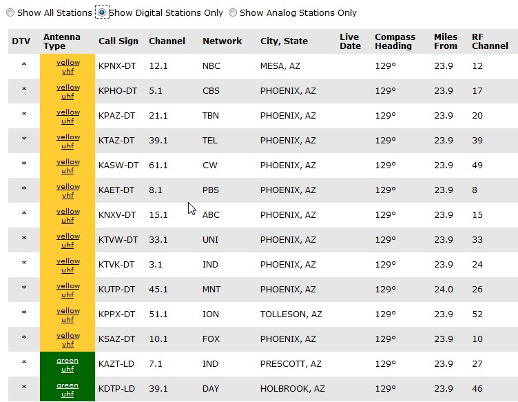

  16. Member edDV's Avatar
    Mar 2004
    Northern California, USA
    I ran an El Mirage zip through antennaweb.org and got this.

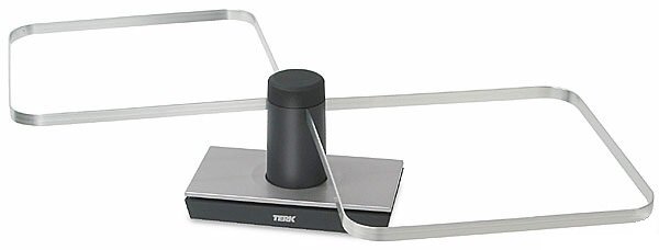

  17. How do you compare the effectiveness of yours vs these loop or bowtie?
    See a lot home made UHF antenna. Is there instruction for home brew VHF antenna available ?
    What can we do for boosting VHF either with a DIY solution, or something under $40 that an be "hacked" (customized, modded, whatever the term of choice), to pick up VHF that are 30-40 miles away?
    I lay behind a range of low hills, but only slightly -- and it's more or less smooth sailing to the transmitters after that, for they lie at a higher elevation, and are atop either buildings or hills as you change terrain and climb up onto the mountains, hills and plateau region.
    I can pick up ABC on VHF, 33 miles away. But the others are about 38-44 miles away. Having just one station sucks.
    Aug 2006
    Most indoor antennas with VHF capability have "rabbit ears". I have one of the few UHV/VHF antennas that doesn't have them, the Terk TV4, pictured below. There's an amplified version too, the TV5.
    I don't know for certain if there are any electronics inside the TV4 beyond a balum and I'm unwilling to take a chance on wrecking it to find out. It might be possible to manufacture similar elements and experiment with multi-element arrays.

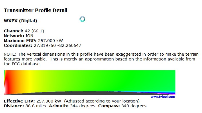

  24. Nope, its the same channel, went from 66 to 66.1. Its called ION. I'm in 33901 zip code.
    It used to come in analog using the TV tuner with a Phillips MANT-10, but the digital station does not detect on the TV or seperate Samsung tuner, or on the Apex converter box connected to a Terk in another room. Had not tried the second two options on Analog, I only found this station after the initial "conversion", when most stations in my area went digital. ION just recently converted, and disappeared.
    AntennaWeb lists it in the Red zone, IIRC, but I'm thinking if I could get it on Analog, Digital should be a possibility.
    I have not tried re-orienting my antenna, getting it just right to receive the three major networks, Fox, CW, and three PBS stations was a major PITA. That's why I asked about combining two seperate antennas.
    We're in Rainy Season here, I have noticed this definitely affected channel scans with the locals, could be weather interference, I've only scanned for it three times.

    There are no longer any UHF stations above 51. 66-1 is a virtual number not the RF channel. The new transmission channel is 42. Bad news from TVFool is WXPX ION is 87 miles away and has multiple hills ("2EDGE") blocking the signal. Click on the station name and see the path. It would take an antenna in this class pointed at the transmittter.

    Any transmitter over 70 miles away has earth curvature issues. It then comes down to transmitter antenna elevation vs. your antenna elevation.
