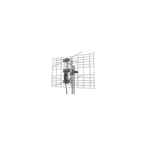

for home check this one.Originally Posted by DJboutit
http://www.amazon.com/Eagle-Aspen-Dtv2Buhf-Directv-Antenna/dp/B000GIT002/ref=sr_1_7?ie...5000161&sr=8-7
