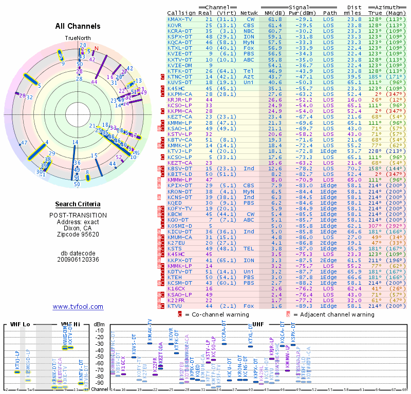

    (Edit: argh - clicked the Submit button by accident. Okay, here goes...)

    Man Dixon-Fairfield is a sweet spot. You can get SF Sutro and Sacramento Walnut Grove.
    Problem is the fog layer in winter that can block both.
    Your strongest signals are from Walnut Grove @ 123 degrees and 22 miles.
    Sutro is 58 miles away and seems to be over a hill.
    So tell me your problems.... I'm listening (not Frasier).

    For the moment, I'm mainly just wondering what the best direction would be to aim our antennas. I get an average of about 20 channels on most scans, and most of them still aren't guaranteed to come in correctly (3, 6, 10, 13, 29, 31, 40, 58). Not that those are the only channels I receive, but those are the ones we're watching out of the bunch.
    Of course, more channels would be nice, too.
    I used to get 2, 20, 26, 44, 50 on UHF, and each of them once or twice on DTV (along with 4), but can't seem to find them, now.

    Do you have an ASTC tuner or ASTC converter box? Analog tuners no longer work.
    (3, 6, 10, 13, 29, 31, 40, 58 ) These are all Sacramento (Walnut Grove) analog stations that were shut down last Friday.
    New ATSC stations (point antenna 123 degrees)
    03 is now digital 35
    06 is now digital 09
    10 is now digital 10
    13 is now digital 25
    29 is now digital 48
    31 is now digital 21
    40 is now digital 40
    58 is now digital 46
    (2, 4, 20, 26, 44) These are all SF (Sutro) analog stations that were shut down last Friday.
    New ATSC stations (Point antenna 214 degrees)
    02 is now digital 44
    04 is now digital 38
    20 is now digital 19
    26 is now digital 27
    44 is now digital 45
    50 Santa Rosa is now digital 32
    There are many more.
