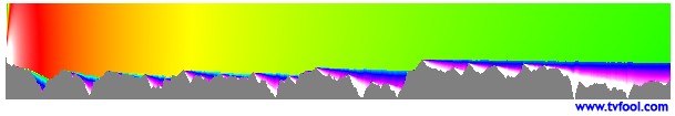

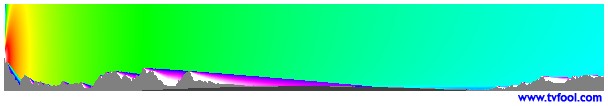

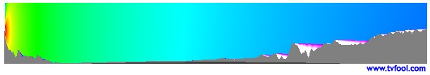

    KTVK (3) doesn't come in real strong. It jumps all over the place and I'm not getting KPHO (5 CBS) or KAET (8 PBS) at all. I am getting KSAZ (FOX 10) and KPNX (12 NBC) though..
    1031..KTVK-HD......3.1
    1101..KSAZ DT.....10.1
    1121..KPNX-DT.....12.1
    1122..Weather.....12.2
    1151..ABC15HD.....15.1
    1152..GoAZTV......15.2
    1211..KPAZ-D1.....21.1
    1212..KPAZ-D2.....21.2
    1213..KPAZ-D3.....21.3
    1214..KPAZ-D4.....21.4
    1215..KPAZ-D5.....21.5
    1331..KTVWDT......33.1
    1332..KFPH CA.....33.2
    1401..KEJR-LD.....40.1
    1451..KUTP-DT.....45.1
    1452..KUTP-DT(1)..45.2
    1511..ION.........51.1
    1512..qubo........51.2
    1513..IONLife.....51.3
    1514..Worship.....51.4
    1611..KASW........61.1
    Someone PMed me and suggested that I point my HDTV antenna towards North Mountain/Shaw Butte. He said he thinks they moved the repeater antennas their for viewers on the north side of the valley. All the main antennas are on South Mountain.

    TVFool has a new feature. They give an obstacle path between the transmitter (left) and your house (right).
    Here is the strong station I get (although only 11.5KW). The transmitter is at 2100Ft and I'm at ~3000Ft.
    Here is a 1000KW CBS station ~60miles away that is just below stable.
    It is my 2nd strongest at 20-35% signal strength. I need a better UHF antenna.
    Note how signals bend down over peaks.
    Here's a 20KW station above Santa Rosa 95 miles away.
