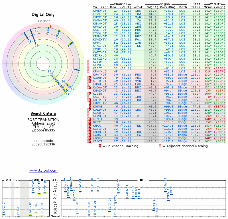

I was getting 27 channels a year ago when I first scanned my Hauppauge HVR1800 with WinTV and a Philips indoor amplified HDTV antenna.Originally Posted by redwudz
A couple of months ago, I reinstalled Windows on a new drive and when I rescanned the channels, all I could get was seven OTA channels. I just rescanned again and now I can only get six OTA channels.

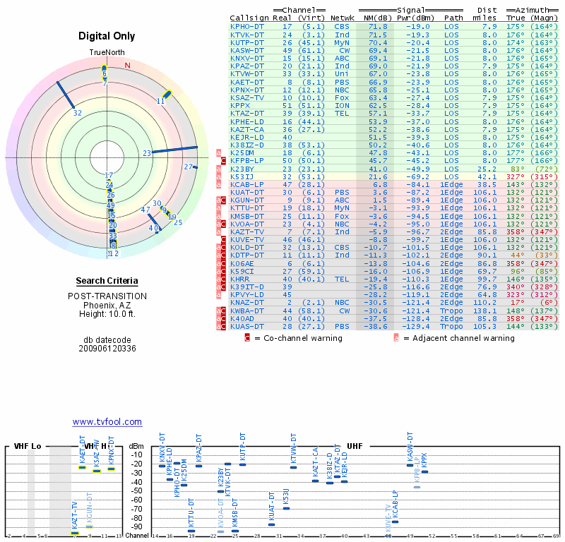

I live in the Northwest Valley. Not sure what the deal is. Here is my OTA lineup...
KTVK-HD
ABC15HD
GoAZTV
KUTP-DT
KUTP-DT(1)
KASW -
If you were downtown Phoenix you would have little trouble pointing an indoor antenna 175 degrees. Major station antennas seem grouped. Run your address through www.tvfool.com to get a similar plot.
