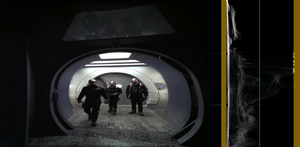

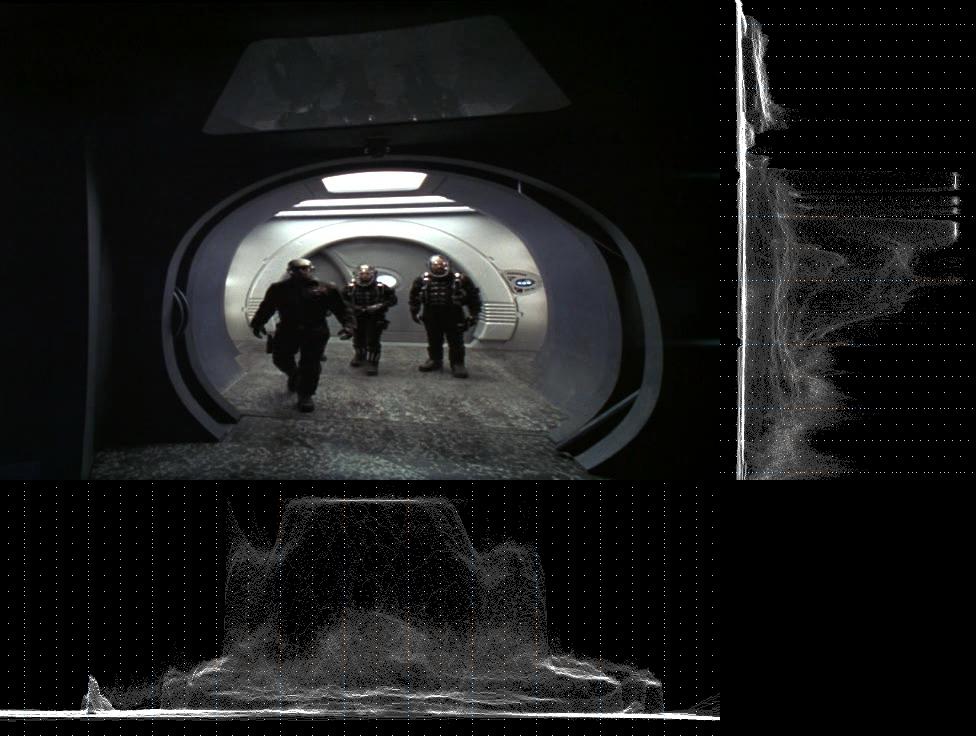

  19. AviSynth's Histogram() and VideoScope() give you a wavform monitor (per line histogram) which is much more useful than a historgram.
    Histogram() clearly marks the areas below IRE 0 and above IRE 100 but it only gives vertical scans (graph on the right). VideoScope() gives both vertical and horizontal scans but doesn't explicitly mark IRE 0 and IRE 100. You have to judge by the tick marks.
    Histogram():
    VideoScope():
    They also have color vectorscope and histogram options.
