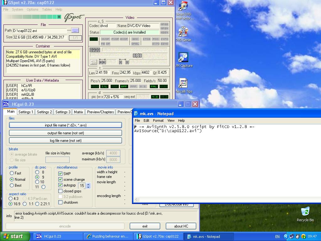

    So I fired up HC and whatever DV (Type 1) file I try to load via the script gives me the same error. I attach a screen grab which shows the file 'captured' with the Canopus ADVC300 using MediaStudio7 (I have no problems editing these files) under gspot, the script and HC showing the error. Even if I re-encode a small part of these files with MSP7 I still get the same error.
    CCE accepted this file with no complaints and successfully encoded the 3 minutes (evaluation version)[/img]

  14. Member Safesurfer's Avatar

    Have you tried using DirectShowSource instead of AVISource in your script?
    "Just another sheep boy, duck call, swan
    song, idiot son of donkey kong - Julian Cope"
  15. Member DB83's Avatar
    Jul 2007
    Thank you ! It finally accepted the file.
    I also needed "ConvertToYV12()" in the script. HC prompted me to add this.

    Ahh, sorry about the misleading "AviSource" - I realized I was testing with an Xvid file, not a DV-AVI. My bad.

    Pray tell me how then. See my earlier post and the screen grabs.
    But then my DV may not be like your DV as it was 'captured'/'converted' through an ADVC and uses a DirectShow Capture Plugin.
    Maybe the 'old guy' knows more than you give him credit. He just does not speak that 'avs' language and needs some assistance there.
    But, for me, this thread is now closed as I have 3 or 4 different programs to evaluate and can then select the best one for this particular job.
  22. DirectshowSource() uses DirectShow decoders. AviSource() uses VFW decoders (VFW is older video subsystem still supported by Windows but deprecated by Microsoft). Windows comes with a Directshow DV decoder (qdv.dll) so DirectshowSource() doesn't require that you install a DV decoder. To use AviSource() on a DV AVI you must have previously installed a VFW DV decoder like Cedocida or Panasonic DV codec (do not use the latter, it's old and full of bugs).
