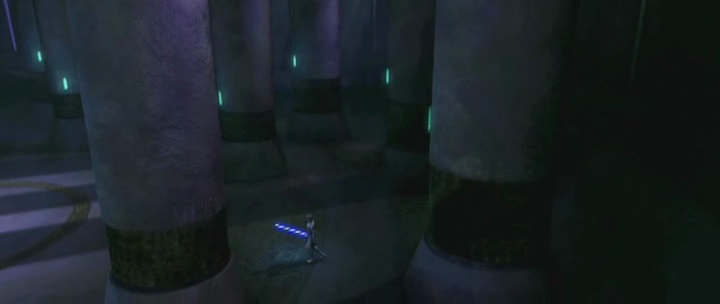

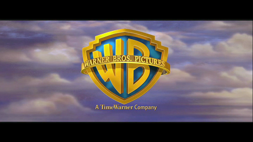

    I had this problem after converting the video:
    Try to look at the Warner Bros' Border.
    and try to look on the lighsaber.
    Those blocking lines (correct my term) appears on the video.
    How do I fix this problem?
  2. It looks like it did a nearest neighbor (aka point) resize. Look for resizing options like bilinear, bicubic, lanczos3.
    It's also possible the problem was caused by a drop-field deinterlace.

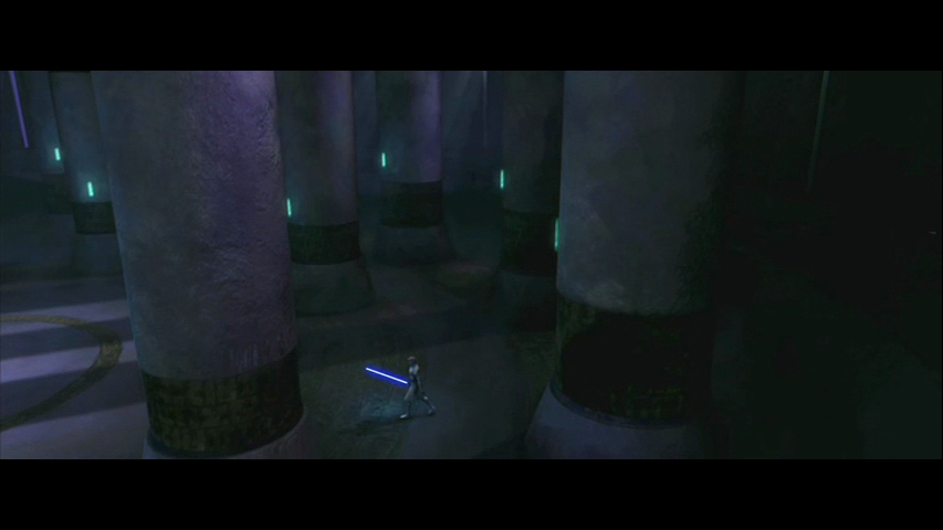

  3. Where's the poor resize? Obviously the Warner logo has a slightly different aspect ratio than does the rest of the movie. Would you rather it crop to the logo and then have too much being cropped from the movie itself? That's possible, if that's what you want.
    AutoGK uses LanczosResize unless the compressibility doesn't permit. Then (I think) it drops down to a Bicubic. It deinterlaces using KernelDeint. However, for a film like this I expect it's all progressive and it wouldn't even have been IVTC'd - just a Force Film in DGIndex. There's no way to know for sure, though, unless helloworld123 posts the AutoGK log so we can see what it did.
    Of course, there's always the chance that if this is an Asian DVD that it's funky for one reason or another (field-blended and the like) and only a manual encode can do justice to it.

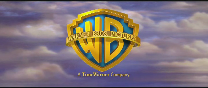

  5. Starting with your MPEG image resized to 720x480, the using VirtualDub's Duplicate Field Deinterlace option gives almost exactly the same result:

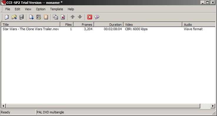

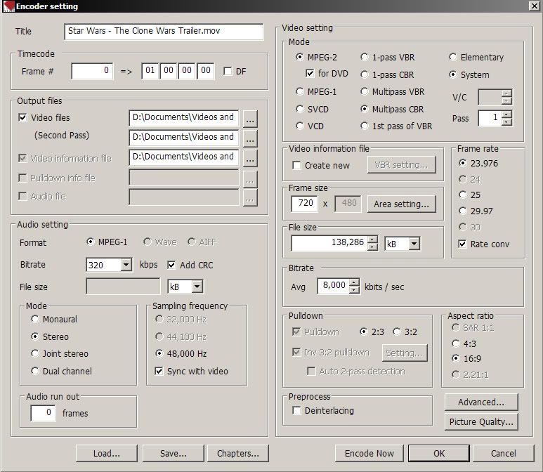

  10. Well, I wanted the trailers to be standalone compatible so I converted the trailer into MPEG2-DVD format using CCE (since AutoGK doesn't support .mov) and convert it to XviD using AutoGK. Could it be a bug in AutoGK that the video was mistakenly identified as interlace?
  11. Originally Posted by helloworld123
    There's a chance (a good chance) that my player was deinterlacing when I was playing it. In any event, we need a piece of the source you used for the AutoGK encode - your CCE reencode. Cut a small 10 second piece using DGIndex and upload it to a 3rd party filehosting site, a place like MediaFire.
    So you take a MOV file and reencode it in CCE before then making an XviD out of it? How'd you get the MOV file into CCE if not with an AviSynth script? My CCE doesn't take MOV files directly.
    And doesn't your standalone play CCE output authored for DVD? If your main concern is standalone compatibility, it seems to me it would be way easier just to make a DVD out of it. Is there more here than meets the eye?
  12. Here's the screenshots I made to prove that .mov can be imported to CCE

  13. Your MPG file is 29.97 fps progressive with every 4th frame duplicated to convert a 23.976 fps source to 29.97 fps. AutoGK tried to deinterlace it which futher screwed it up.
    <edit>
    I got the MOV from the apple web site. The duplicate frames are in it too. A quick decimation with AviSynth and conversion to Xvid AVI:
    DirectShowSource("G:\Downloads\starwarsclonewars-tlr3_h480p.mov")
    SelectEvery(5,1,2,3,4)
    BilinearResize(640, 272)
    http://rapidshare.com/files/242327836/sw.avi.html

    Thank you. I didn't realize SP2 could import them directly. I should have said I was using the SP 2.70 version. In any event, it still seems like wasted effort as you could be making a DVD from it (as I think you said you already did) for playing on the standalone.
    As far as I know, there's no all-in-one app that will do what's required here - just remove the duplicate frames to make it 23.976fps. Nor is there any way to get AutoGK to just leave it alone and not deinterlace at all (unless you use one of the 3rd party add-ons for AutoGK which allow editing of the .avs so you can remove the deinterlace line). It does seem to be a mistake to find any interlaced frames at all (as the log says it did), and it's not designed to spot and then remove duplicate frames to handle this kind of source. Neither does the "Force IVTC" box in the Hidden Options work unless the source had been determined to be a hybrid (which this wasn't).
    Your source is a bit unusual, and as is often the case for such sources, it's best handled manually (as jagabo demonstrated).
