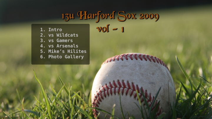

    I'm also going to suggest using multiAVCHD. It will support multiple resolutions and frame rates. You can create your own custom menus, but you are limited in the tittle placement. You can't change the button locations. It still allows for some nice looking menus if you're creative. Here's one I did the other day:
