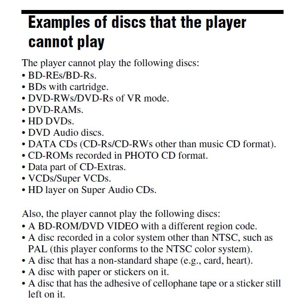

I went to SonyStyle.com and downloaded a copy of the owners manual. On page 6 it shows that the BDP-S300 does not support playback of BD-R or BR-RE media. See screen capture of page below.
Thanks for the insight. I thought that Sony corrected this with firmware upgrades. I was worried I upgraded my firmware to a version that doesn't, but all indications is they fixed it. I will go in and try it at a store.
Well I just got back from the store and tried it in a BDP-S360 and guess what, it played fine! So I guess the answer is my player. I will be replacing it unless anyone knows of a patch to make it work!!
