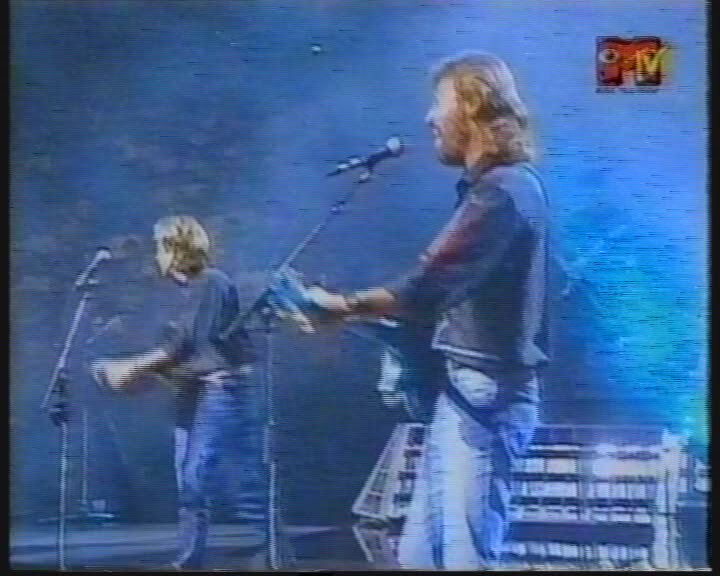

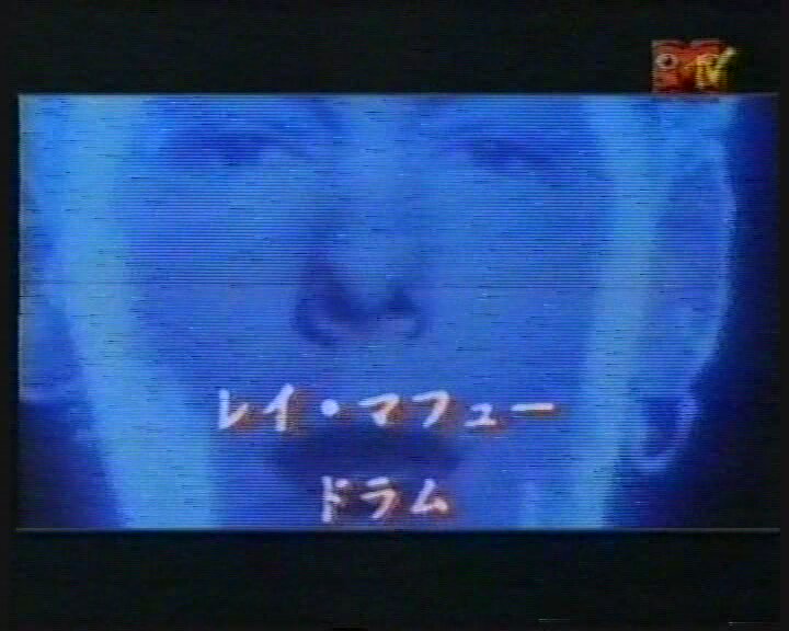

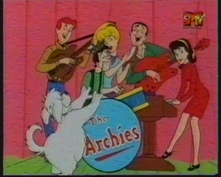

OK, those are fast screen caps from LP VHS, recorded somewhere late 90s.
Direct capture, without even TBC.
They are from MTV India. C band reception. I use to tune the receiver that way, to have black and not white sparkles mostly. Some times colour ones would appear.
The white on the bottom and on the right, are more thin and they are from tape. But all the blacks are the one I wish to kill them. The thing with the sparkles, is that they appear only on 1 - 2 frames, so a smart temporal solution is needed.

I can't believe that someone recorded The Archies. I used to watch them in the early 70's. Gosh. Anyway.
1. while reviewing the pics, I couldn't help notice the great amount of mpeg pixelation..it was hard to decirn streaks or sparkles because of this: in mpeg with a lot of pixelation, it gives similar sparkels (gradient lines) and confuses which is which.
2. if you post a two second clip, that might help more. The Archies might be a good clip to post.
