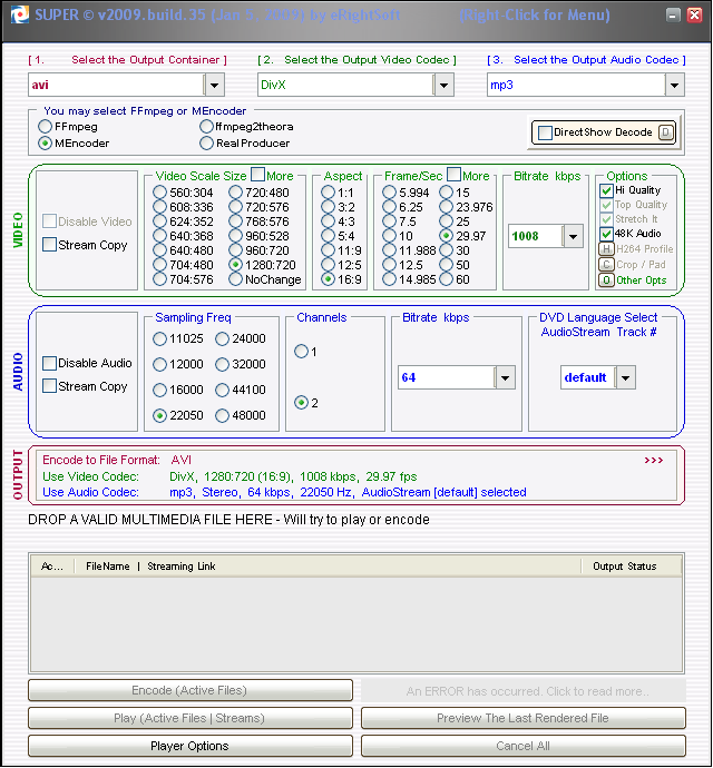

    @Baldrick: I use DivX as the Output Video Codec for Super. I haven't really tried the rest of the codecs while attempting to convert. But would be glad to try other

    EDIT: Appears the problem is fixed when I changed MEncoder to FFmpeg in the section above VIDEO.

    Just to show the settings that I have originally set for the video conversion.
